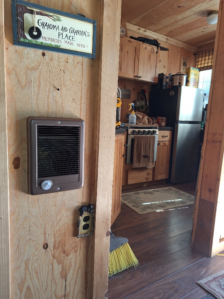

# Posted: 28 Nov 2025 01:16pm
Quoting: MikeOnBike
Our cabin will be unheated/unused over the winter with temps falling below 0F. I'm thinking about using a wood laminate floor over a plywood subfloor. Since these float I would think that it should manage the temp swings pretty well.
This is exactly what I have temps dropping ro 0 or lower and not an issue. Mine floats, no glue or nails, not even padding, its attached to the planks. Just snaps together. I found a recent picture of the laminate flooring. It all floats so can expand and contract as needed, but its dense enough material, no real movement at all.
Picture with view of flooring

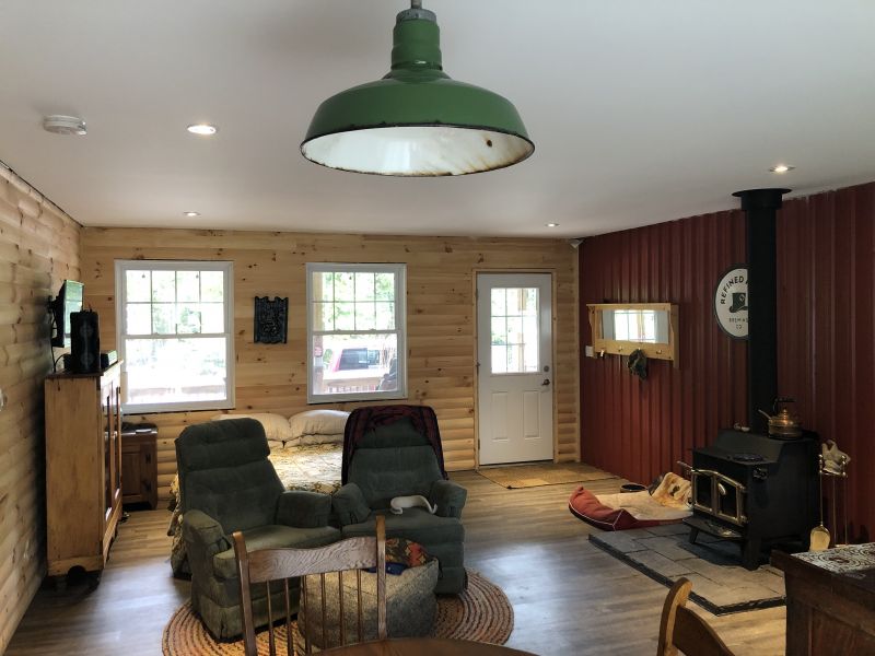

# Posted: 29 Nov 2025 09:27am
We used vinyl plank flooring…it’s extremely durable and was recommended to use for unheated spaces. We laid it 3 years ago and still looks new. Out of 1100 sq ft, there are two minor areas of separation over each bedroom threshold…which come back together after the wood stove is on for awhile or when warm weathe4 comes again. Cabin is in Tobermory, Ontario…gets plenty cold up here!
Flooring in main area
