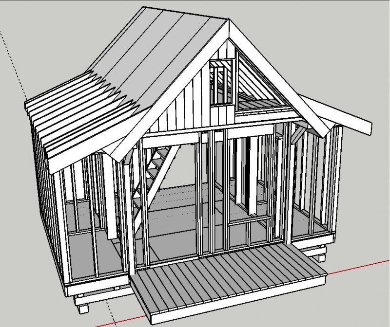

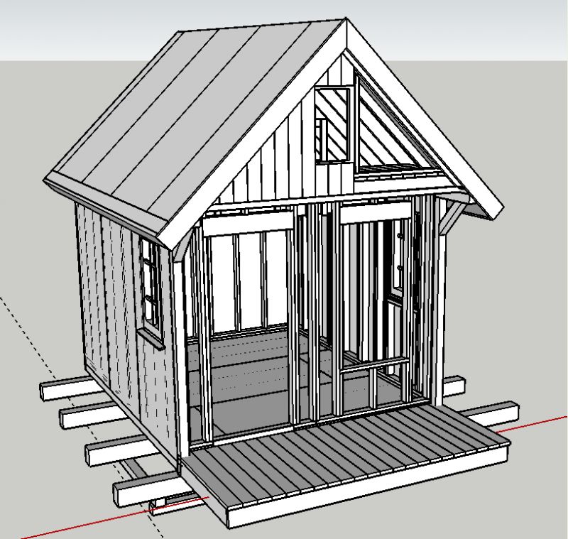

Hi, my Bunkie is 10x12, it's on blocks, on a slight incline and sitting between two large trees (in Canada). It's pretty solid as is, and seems to accommodate small frost movements, but I wanted to widen it from 10x12 to 16x12 (3' extension on each side). I was going to run 5x16' beams underneath, raise it a few inches and build the 3'x12' extensions on each side.
Has any tried expanding a Bunkie that's only on blocks? Is the frost going to rip it apart or is it still small enough to handle a little movement?
Bunkie 10x12
Bunkie 10x12
Bunkie 16x12
Bunkie 16x12

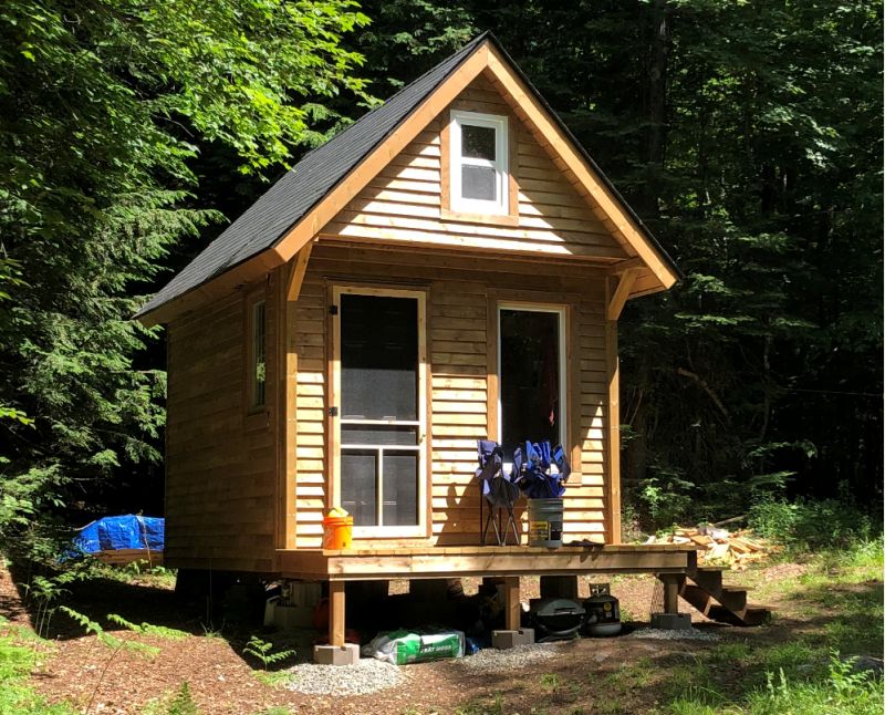

derek4u
# Posted: 5 Mar 2020 08:59pm - Edited by: derek4u
This is what it looks like now!
Bunkie Before
Bunkie Before

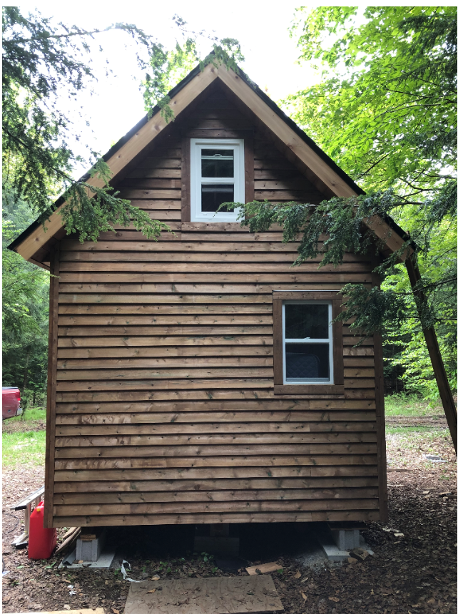

derek4u
# Posted: 5 Mar 2020 09:07pm
You can see the blocks better here..
From back
From back

Quoting: Brettny
I think the best thing to do is to jack it up and run new beams 90* from the ones that are already there. Support on blocks as needed.
I think that's exactly what his plan is based on CAD renderings above. With that in mind I believe it would be fine, as the entire structure would "float" as a whole on a new cross beams/skids.

Yes, the first sketchup shows 4 6x6 beams running perpendicular. I was actually going to use 5. Maybe a lot of work for an extra 60 sq feet, but I love this bunkie - it's just really small!
The ground consists of a lot of mature tree roots and lower spots that get wet in the spring - so no chance to go below frost line.
derek4u
# Posted: 6 Mar 2020 10:06am - Edited by: derek4u
I would have to support the beams along the existing edge of the cabin (10' apart) and then on the ends (16' apart), but not centre as I can't reach underneath.

Why not build the foundation and outer walls like your saying then from the original ridge board run new rafters from it to the new outside walls. You could remove one old rafter and install a new longer one in its place very easily. Such a small cabin I'm sure would benefit from some head room.
With the two bump outs in your drawing you would need to keep the old exterior walls under them as there still load bearing. What would you do with a 3ft wide section the length of your cabin?
