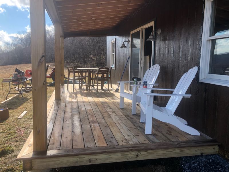

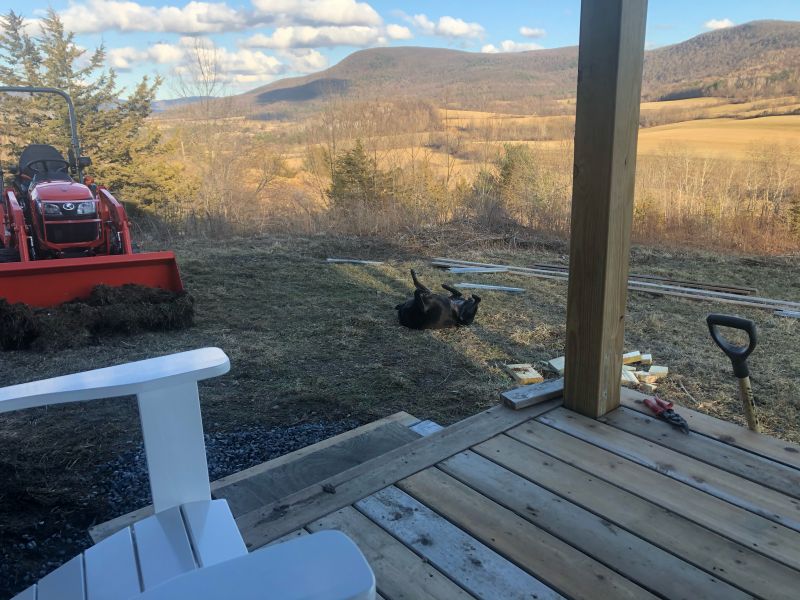

# Posted: 13 Mar 2020 07:13pm
Went with 5/4 cedar decking. Got it all for $150 from the seconds pile at the lumber yard.
# Posted: 14 Mar 2020 07:34am
Beautiful job! Great view too.

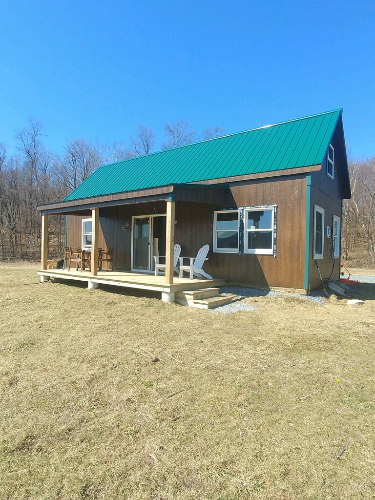

Irrigation Guy
# Posted: 14 Mar 2020 06:37pm
Quoting: Brettny
Thanks! It’s Nice place for an adult beverage or 3
# Posted: 14 Mar 2020 06:42pm
Nice! Love the rim board... really finishes it off. I'm too lazy to do that!
Irrigation Guy
# Posted: 15 Mar 2020 07:40pm
Finished up the steps and am now back home to deal with kids home from school for at least 2 weeks and a wife freaking out about coronavirus. Wish I was still at the cabin.
