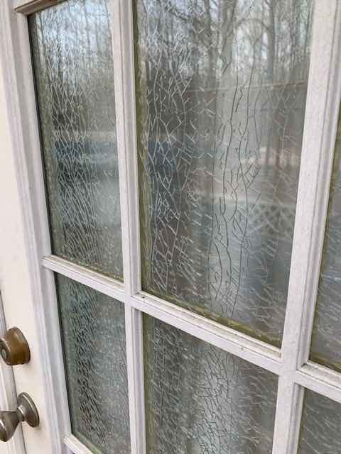

Hello- Any suggestion appreciated: I have a French-style patio door and now a single glass pane window has cracked ...badly. Is it possible to replace only the glass pane or will i need to replace the whole door (or just one side of the door)? I have attached image. Thanks for any suggestion!

Are those individual panes of single glass? You may have difficulty in finding glass with a matching pattern.
Is that a storm door or "the" door?
If that is the main weather barrier door, I'd install a new prehung door with modern dual-pane lites to have better insulation values that can be had today.
If that is a storm door I still might give some thought to a new door unless I could match the glass exactly. But then I just hate things that look like a patch up job and that is what it might look like unless the glass was a very good match.

You can buy new window inserts but you may Need to make the hole in the door bigger. This being a single pane window if it's not a storm door I would look into replacing the whole door.
Don't buy a door from a big box store. They suck.

Easy glass replacement. The interior should have screw caps or cover strip. Pop those off and in screw it. The outside may have adhesive so you'll have to run a knife around the frame and push it out. Most building centers have replacements It's easy with 2 people. One holding the glass from the outside and the other screwing from the inside.

Thanks so much to all. I should mention the damage is in a single pane of a dual-pane door glass. It’s the door that leads to the porch area, so it’s exposed to the elements! Thanks a lot for your helpful suggestions and will follow up on them.
