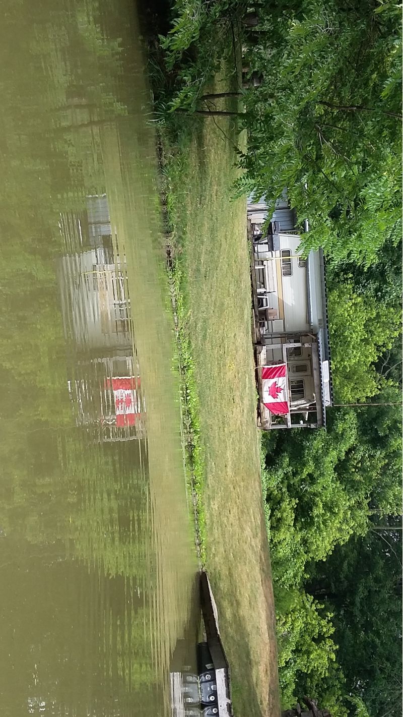

Old camp 1976 trailer been there for 13 years cost me 250$
Camp
Camp

# Posted: 22 Mar 2020 11:41pm - Edited by: Gary O
Quoting: Just
Turned it for ya, Just...aaand cut it down a bit to fit
