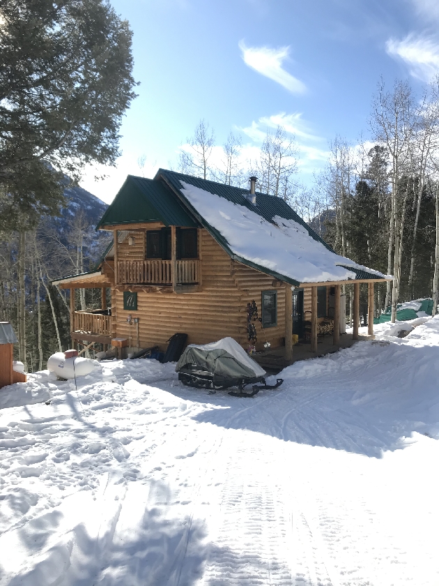

# Posted: 26 Mar 2020 09:52am
Picture of the north side this winter.
Cabin North Side
Cabin North Side

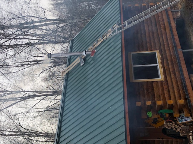

# Posted: 26 Mar 2020 05:30pm
I built this janky ladder out of 1x6 and 2x4. I weigh 200 lbs and it supports me just fine. Do you think you could build a small ladder on porch roof, then build a small catwalk across your ridge? You could walk onto your porch, up a small ladder then down the catwalk. It would still let snow slide down your main roof.
Being a 12:122, just need to make your hooks at a 45 degree angle.
Just a thought.
Roof ladder
Roof ladder
