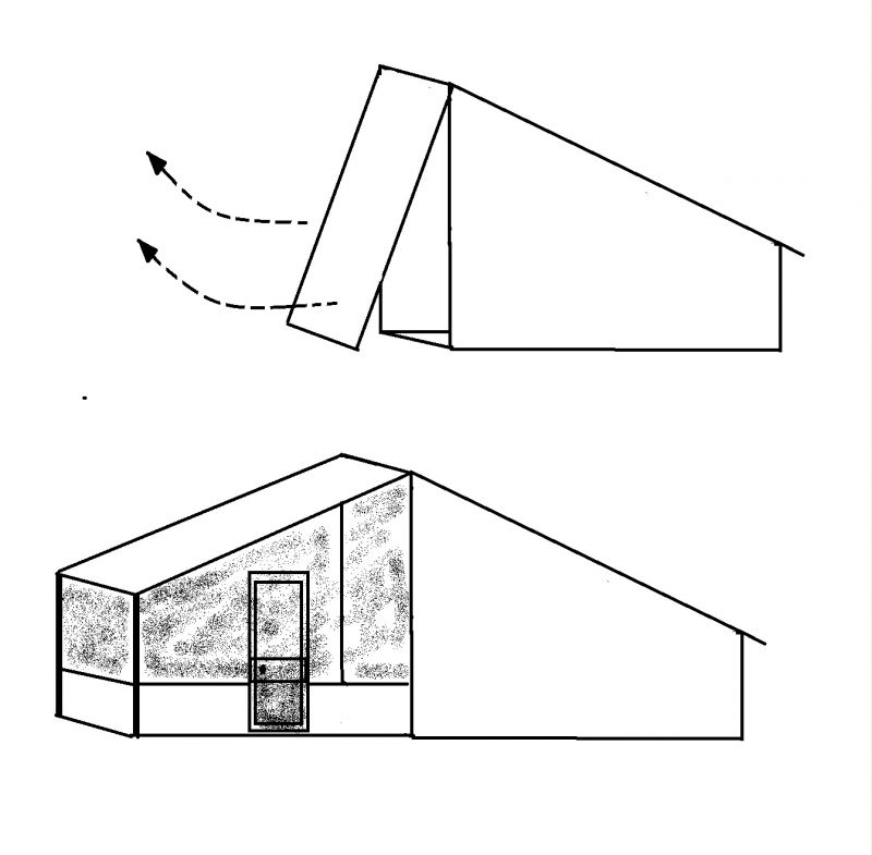

You mention 10 x 10 is the max permitted. If you truly want to stay with what you are allowed, better check height regs too. However, that aside, I've been thinking those that are just needing an occasional camp cabin, but are constrained with size, a hinged wall might come in to play, making a deck into a screened in porch, with half walls. Thus, more room, and when closing up camp, drop 'er down and button 'er up. Assuming a lean-to shed type structure is what you're after.
My thoughts

# Posted: 27 Mar 2011 02:26am
i like that! definitely thinking outside the box.
We will be OK on height. They allow up to 25', which again goes to show the crazy stuff going on at the local planning commission. Only would the local government restrict you to 100 sq. ft. without a primary dwelling but in the same sentence say your structure could be 25' feet tall. I should go that tall just to show them how ridiculous they are. That'll show 'em!

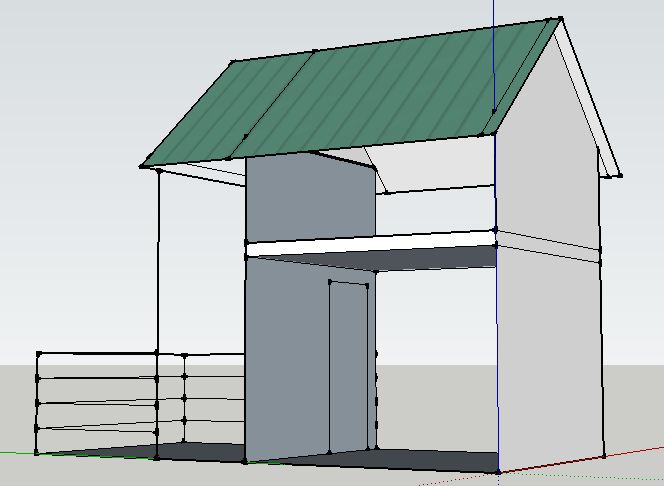

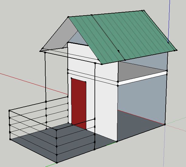

# Posted: 27 Mar 2011 03:30am
I saw some people using Google SketchUp, which I had never heard of before, but I thought I would give it a shot. Here are a few rudimentary designs of what I am thinking.

MikeOnBike
# Posted: 27 Mar 2011 06:56pm
Bummer.
If you use a good set of brackets to connect the structure to the piers you shouldn't have to worry about it blowing over. You are only 3' taller than a regular shed with a 12/12 pitch roof.
If you put some windows in the gables it will help it keep from looking quite so tall. The extended roof out over the deck helps keep it from looking like a chimney.
Looks pretty good, code or site limitations can lead to some pretty innovative solutions. Keep working on your Sketchup model and you should get a pretty good idea of what the final out come will be.
What are you going to use for siding/trim materials? Do you have any site pictures?

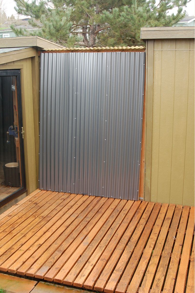

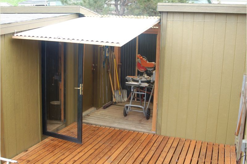

MikeOnBike
# Posted: 27 Mar 2011 11:30pm
The Hardie siding was a little more difficult to work with than many others but I need the fire protection. It's thin and brittle but the only piece we broke was one that I accidentally stepped on. That would have broken even T-111. It was hard to start a nail through but we got around that buy using an old finish nail set as a punch so no big deal there. An air nailer would also solve this problem. I'm going to use it for my other shed project this spring.
