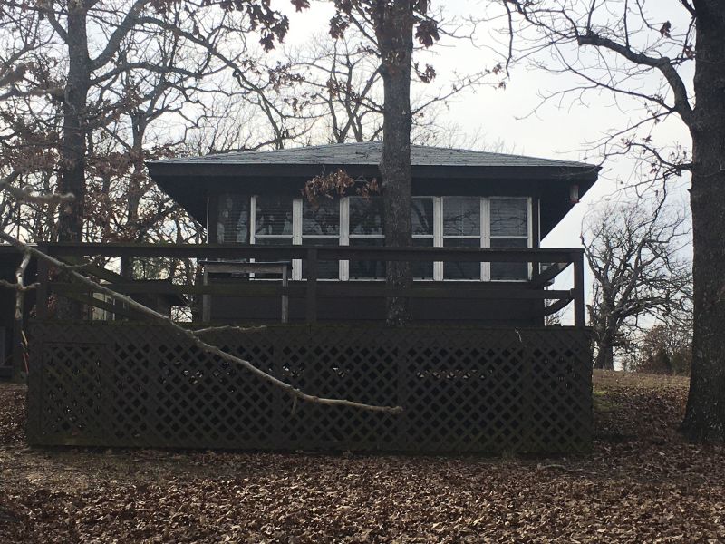

We have a small cabin we bought from my wife grandpa and would like to add a small bath room and closet etc.We want a small bath with shower,sink and toilot.As well we would like to have room for hot water(tankless or tank)and small closet area or use it for washer & dryer.Were would you put the additions that make it visually appealing,we can do what ever we want to the inside as there’s only one wall we plan to remove.Thought about putting a sliding patio door in the wall of windows to eliminate a inswing door.

Its about 14x20 split in two rooms.
Actually i want to add the room to the exterior,basically add a 5x8,6x6 etc lean to or room on the front side or one on each side to make more living sf.
# Posted: 31 Mar 2020 07:21am
Your really going to have to mess with the roof line on a building like that..or deal with very low headroom
Coopsdaddy
# Posted: 31 Mar 2020 07:32am
I hate the low ceilings but i have to live with it,there 7ft3.

# Posted: 31 Mar 2020 10:36am
The ceilings are alreaty 7ft3? That's a terrible start if you don't want to step down.

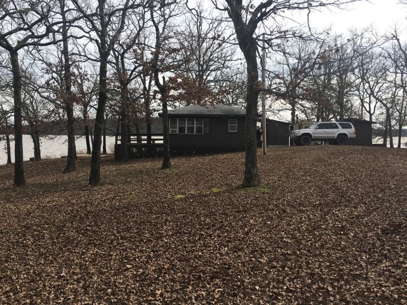

I hacked a bathroom on the back of my 12x25 just as you are describing, but fortunately there was nothing to see or do back there prior, and I had a high roof line.
On yours I would probably choose the front, where your truck is parked, and go all the way across with a lien to roof or carport. Dig down if you can.

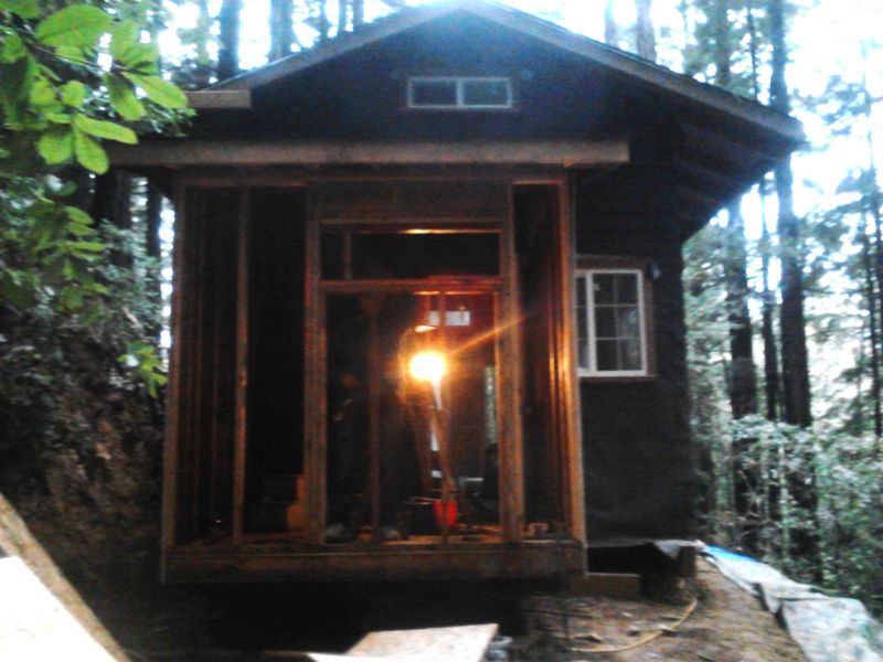

# Posted: 31 Mar 2020 01:38pm
How good of a framer are you? Adding on to a hip roof is hard for a novice, but easy for an expirenced builder.
Basically you will have to add a gable roof coming off one of the hips. Something like this. It's not hard, just a lot of angles. Then you can add as much room as needed.
# Posted: 31 Mar 2020 05:43pm
snobdds, has the best way to do an addition. That will retain the same headroom as in the main cabin.
