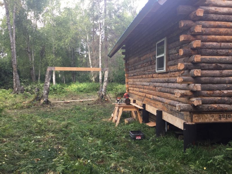

Hello Mkobzey and welcome aboard. I built a remote 16’x24’ cabin with 3 sided logs. For us, my beautiful wife n me the allure of being remote was a draw. And having to freight supplies strategically was just another part of the build.
Build what you’re dreams are. Conquering problems is part of the fun. And many will be unique to your situation so there is no one size fits all.
I used used power line utility poles that I sourced from a local company that does this work. These are cedar poles that have been treated to withstand the elements and have a fairly large diameter to use as a footprint. And I could cut them to 8’ and get them out on a freight sled in the winter. We have to fly in in the summer and then two miles to the cabin across muskeg so as I wrote earlier planning is essential. But I really enjoy that part. Why I’m here, to learn.
Set up batten boards to hold a straight line and drilled the holes with a two man hand held auger to 4’ that the machine would dig. Got it down through overburden and couple feet into rock drainage base. Compact bottom a bit with a spruce pole. Wrap a couple times with tar paper because I had some although I question the need. Some say it allows the frost to slip around the pile or avoid direct soil moisture contact. I have seen no effects of any damage. Backfilled with redimix concrete that we melted snow with. My thoughts that it would compact around the poles and surrounding earth better and keep water from the poles. You may notice the almost 4’ overhang that keeps the drip line away from the base. I have always planned on going back and putting a cement cap per say around and up the base of the pole where it goes into the ground but haven’t got there yet. But I’ve kept a good eye on things and can see no damage to the poles.
I used 5 poles set in 3 rows so effectively 6’ on center 8’ apart. I built ours 3’ off the ground for several reasons. Wanted the widows high enough so the bears couldn’t reach them mostly but keeps the snow off the cabin. We get lots of snow. 5-6’ of snow on the building’s. And we don’t have to dig down to get to the door. And to handle the weight of the logs.
Was easy to cut level across the top. Snap a straight line exactly where it squared up the cabin so I could cut a should into it . To except a 4â€x 12†x 14’ beams that I got from the sawmill who cut my cabin logs. Then fastened to the pilings with 1/2†galvanized bolts.
Ending up with 3 rows of 4†wide 28’ long. There is a 4’ deck on front and it also allows the roof in front to have a 2’ overhang to keep the snow off the decks. As they stick out far enough to hold the roof.
This cabin has really been a blessing to me . There were plenty of challenges. Took 5 years just to get everything there to get started. You can read more on my thread. Overcoming the challenges is rewarding.
I’ll be glad to offer any positive advice I can for you. As will others who make this place a great site.
