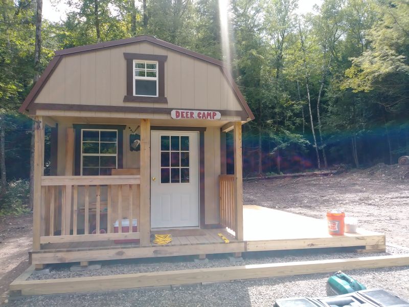

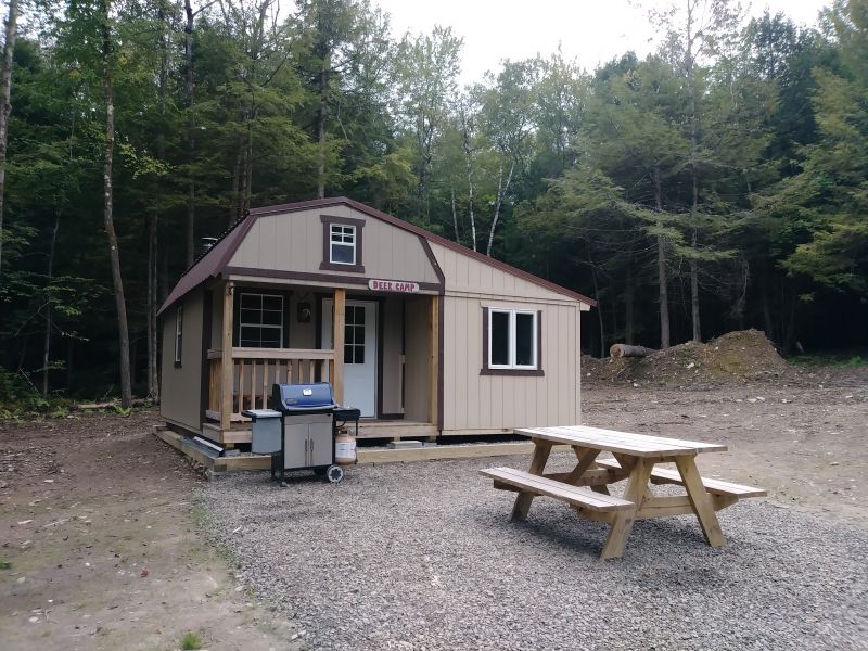

deercula
# Posted: 15 Apr 2020 10:55am - Edited by: deercula
  I took the Amish route and couldn't be happier! None of the usual hassle that contractors put you through.
   Going on 4 years and not a single problem.
   The biggest advantage, besides lower cost, is that they know what the locals require. My builder has been in the area for years.They knew just how deep to put the piers, roof pitch, overhangs, insulation etc.. Built to my drawings exactly. I chose where to put windows and door, cabinets, heater, loft etc.. They used their knowledge to decide size of lumber, spans, spacing etc..    I would use them again in a heartbeat! Consider them "craftsmen" not just builders.
