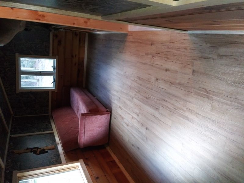

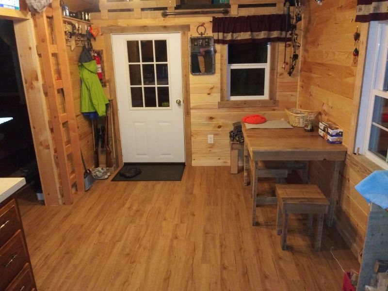

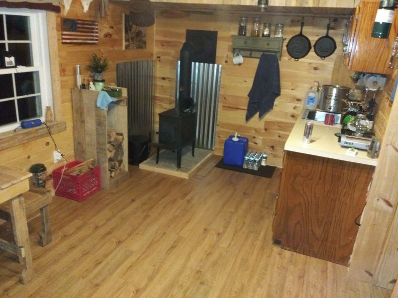

After debating between carpet, wood and vinyl, I went with vinyl plank for my cabin. I picked it up in Floor and Decor for $1.39 sq foot, 4mm with pre-attached pad. I did use additional underlayment and sealed all gaps in subfloor with silicone. Subfloor was 3/4 inch treated plywood and I had some minor draft. Just finished yesterday. Floor is floating click waterproof vinyl planks. We'll see how it holds up.
xtolekbananx
# Posted: 18 Apr 2020 10:37am
