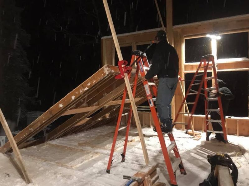

The subfloor on our new cabin is plywood. It is coming up on 18 months of exposure. I'll let you know how it looks once the ice melts out.

I went with plywood vs OSB because I knew it was going to be exposed for a while. I hope to have a roof over it this summer.
