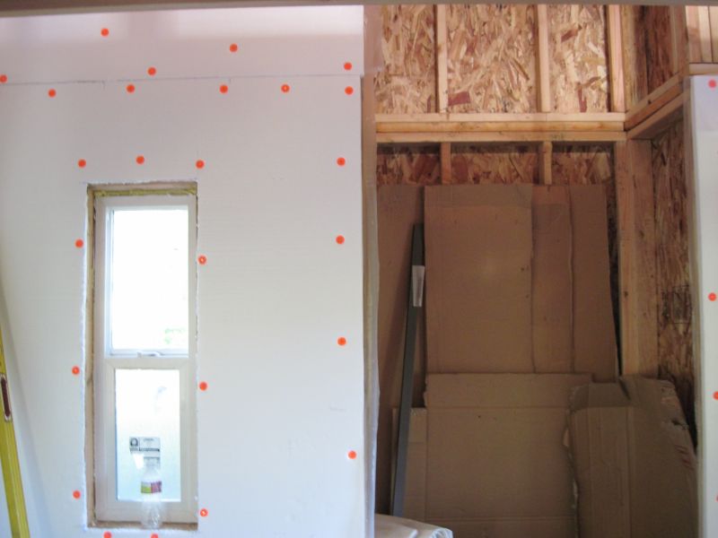

# Posted: 1 Apr 2011 12:35am
My wife and I did a combo of insulation. R13 in the 2x4 walls with 1 inch foam board on the inside. House wrap with reflective insulation too. Not sure what the R value is, but it seems to work good. I would take the time and do it right the first time.
Inside picture with foam board
