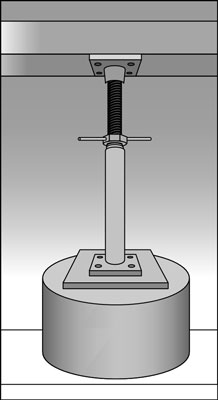

Sketchy...
If your building in clay soils...you have to have a foundation that does below the frost line. If you don't have clay soil, you can probably get away with a some sort of pad foundation. But it will settle over time and need adjusting. Build in adjustment mechanisms to do that before you build.
doglvr
# Posted: 1 May 2020 01:35pm - Edited by: doglvr
"Build in adjustment mechanisms to do that before you build. "
Such as.....
snobdds
# Posted: 2 May 2020 10:26pm
A heavy duty screw jack.
