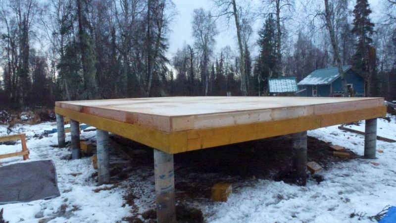

My Amish builder used (12) for 16' X 30' in S.W. N.Y..48 inches deep. 3 rows of 4. Some people advised not to put a row in the middle because they sink or lift, causing the floor to "hump". You would need to use larger floor joist than my 2X8. No problems yet in 4 years. Check out my build thread for photos:
https://www.small-cabin.com/forum/6_6589_0.html cabinstart5.JPG

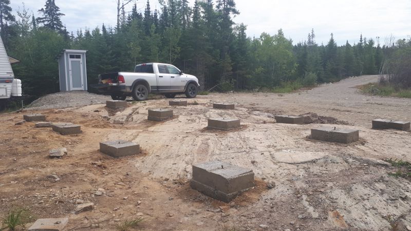

I'm starting my 16x24 cabin this spring. Last fall I poured pier pads for the cabin to go on. I'm on bare bedrock and I poured 12 piers. I just winged it. I looked at some other camps in the area and online. I feel it probably is a bit over kill. I could have probably got away with 9 but I'd rather have more then not have enough.

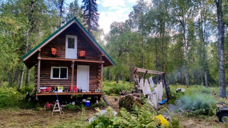

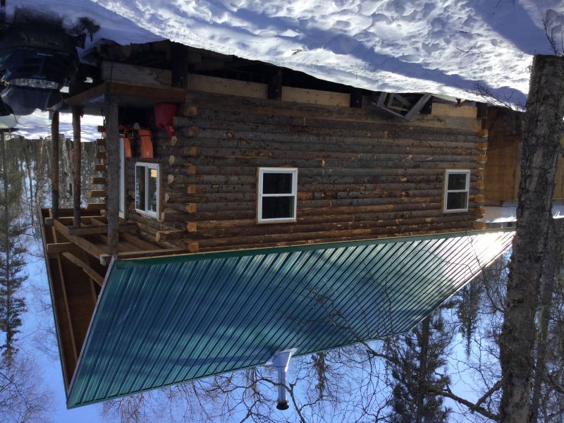

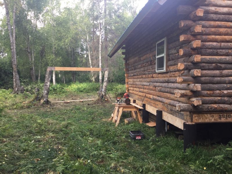

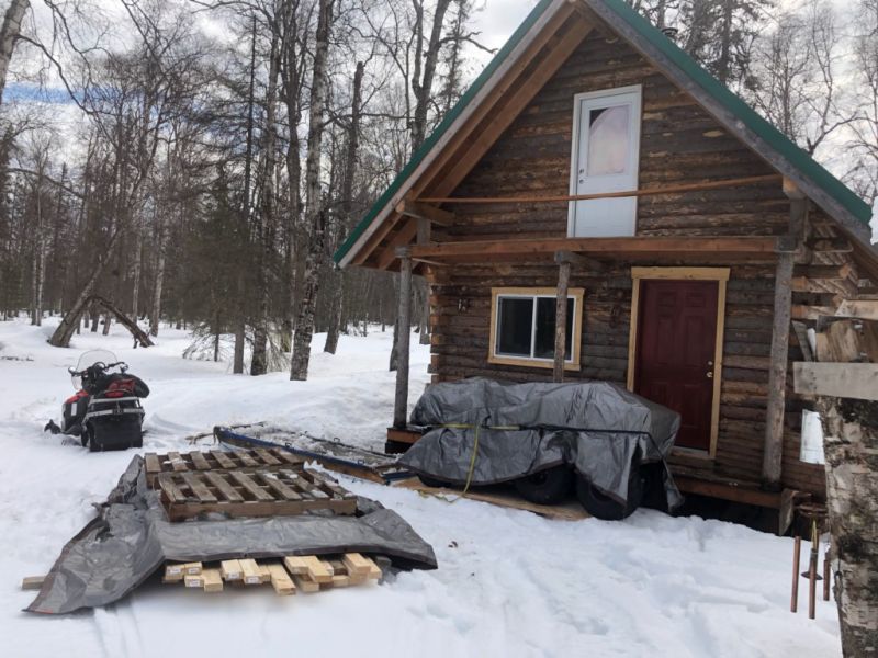

Hello TV . I built a 16’x24’ log cabin in s c Ak. I used some cedar utility poles for a foundation. I’m remote so needed to deal with that. 3 rows 5 per row. 6’ apart. Having 3 rows will keep your floor from bouncing. I have no problems with frost heave and this cabin has has had no damage after our last 7.2 earthquake and loooooots of snow. Or bears , yet on the bear part. No guarantees there. I used 12â€-16’ tji for floor joists and 4â€-12†beams from one of our local sawmills notched into a shoulder and bolted through the foundation poles. Your in Ak. You will be dealing with bears and lots of snow. I designed it so the windows were 7 ‘ high. So bears can’t reach them. And used 16’ 2-12 for the roof. That gave me almost 4’ of overhang and puts the drip line out further. With the height and extended drip line the snow shed from the roof never gets close to the cabin. And able to use r38 insulation in the lid with an inch of air flow for a cold roof effect. And 3’ of storage hight under cabin. Also a nice view. Don’t know if you’re remote but if you are. You may want to also know where your generator shed will be. It is behind the cabin and I have a walkway between them. I also insulated ours . I have an air conditioner for it so I can use it as a meat cooler. Enjoy your build. East side
|  West side
|  Whats for supper
|  My polaris 6-6 on some plywood

That is a nice looking cabin. I wanted to do a loft, but the hubby vetoed it. We have only had a black bear pass through last fall. We do, however, have a lynx that frequents the property, because we have lots of rabbits for him to eat. He was around all winter.

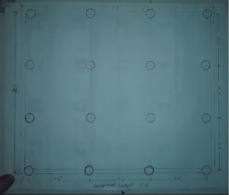

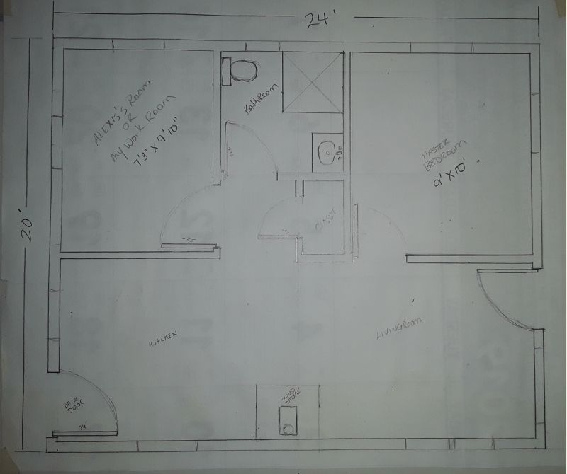

NorthRick, I did mean frost depth. A guy about half a mile from us had to go just over 4', so we are planning 5', using 10" tubes, with a foot above ground. I spent a little time today and worked up a tentative tube layout and did a rough draft of the cabin floor plan. Tube layout
|  Cabin floor plan

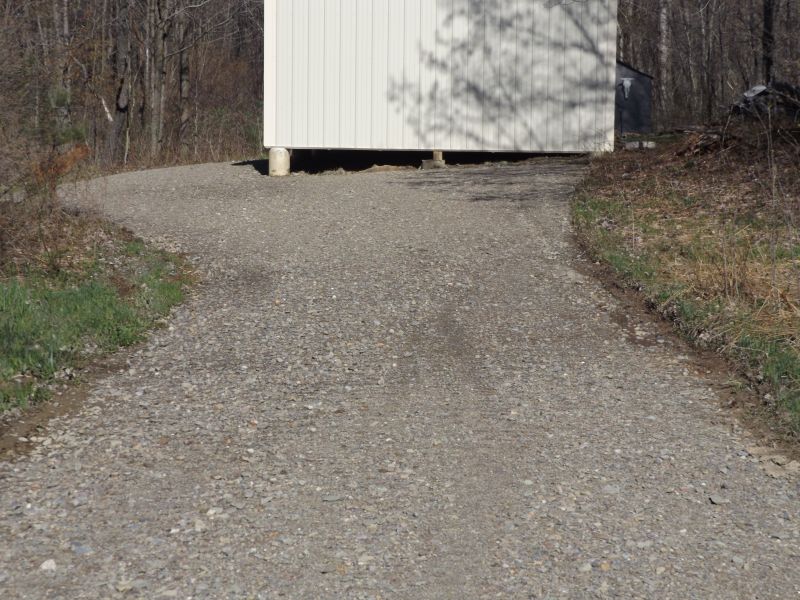

We are building in central NY. We are going to do a 20x24 cabin with a 8' porch off the 20' side. For the 20' side I don't think you need 4 rows of tubes. 10' floor joists are easy to get, if not use 12' and lap them.
Pull all your tubes in under the floor joists and girters Under there they wont get splashed on with rain and have a chance of getting the underside of the cabin wet.
Anything less than 12in sono tubes here is not to code. Not sure where you are.

TVaught32, how are you planning to do your roof? Trusses, a ridge beam, something else? In my opinion you have more tubes than you need in your draft layout. Which ones to get rid of depends on how the roof is going to be supported.

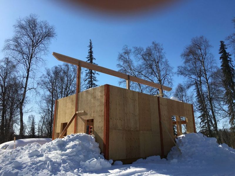

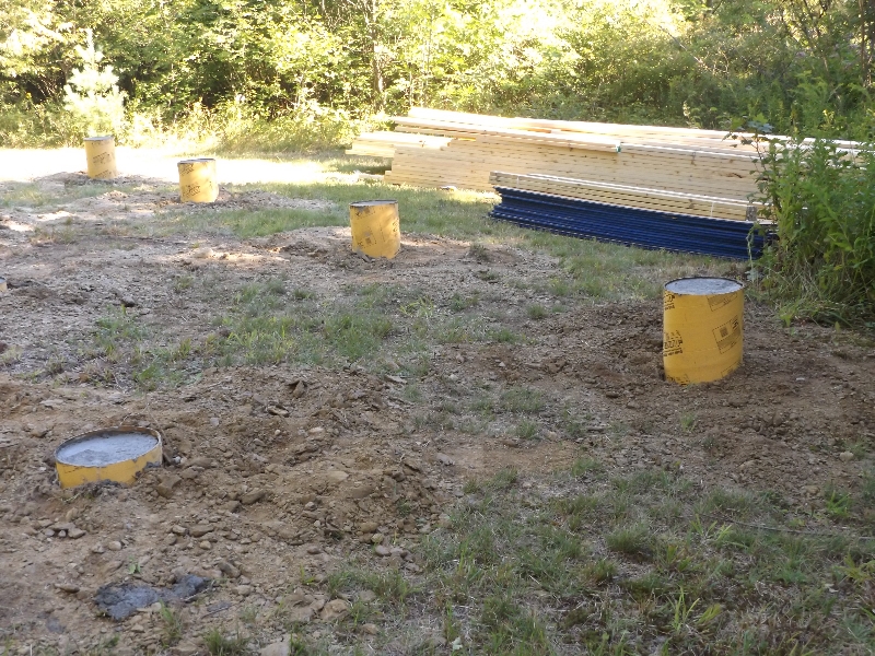

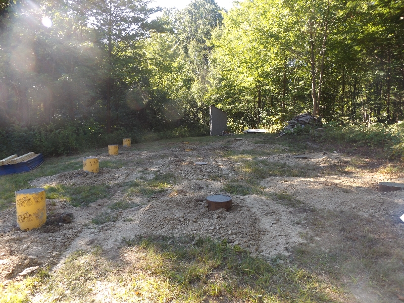

I'm building a new cabin that is 20' x 32'. The roof will be supported by a ridge beam. That means the 3 posts supporting the beam and the side walls will be taking all of the load from the roof. I've got 4 tubes on the outside walls and 3 down the center. The 3 down the center are directly below the posts that support the ridge beam.
What you can't see in these photos is that I used Bigfoot forms on the bottoms of each tube. They spread the load on the soil beneath them and also resist upload (wind, frost jacking).
