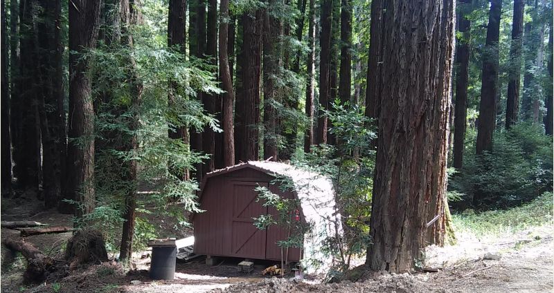

I have one of those premade, or made on site, sheds a friend gave me, it was in the way of his home addition. I cut it into sections, flopped it on my trailer and put it back together, about 5 years ago. It's been great, dry as a bone. The roof panels run the other way of the norm as you can see.

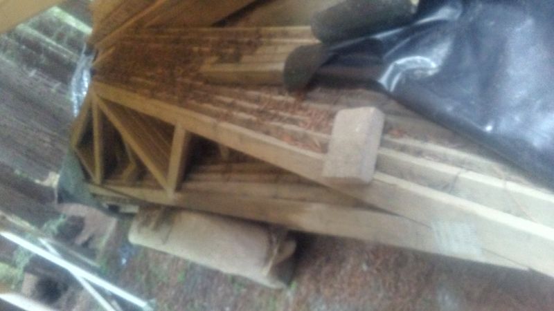

One of my 2020 projects is to build an open carport with some leftovers, using trusses and 25' metal panels I have laying around.
Would it be a mistake to run the panels in the same direction as on the shed? No snow in my neck of the woods.

I wouldn't... surely you get plenty of rain judging by the undergrowth and those beautiful big trees! If you are trying to save money on sheathing the roof, you could do skip sheathing using 1" x 4" to screw the metal to.

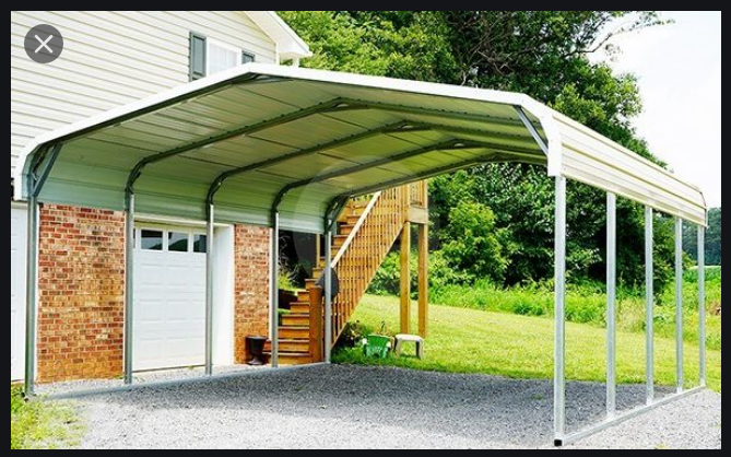

There are lots of commercially sold carports that use steel roofing panels the "wrong" way. They are screwed to metal legs that are usually formed with rounded angles where the vertical legs/post curves to form the "rafter" portion. Google metal carport and you will find what I mean. The makers of those often will sell extra panels the allow dropping the metal down the sides. I have a couple of those and they are great when one does not need a total enclosure.

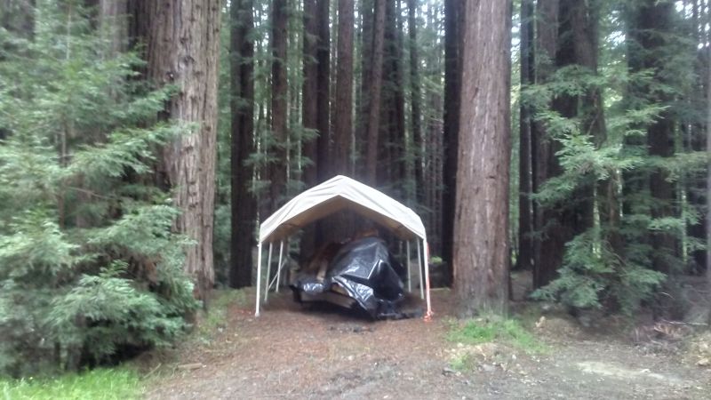

It's going here, in place of the canopy.

Hmm, like this.. Pretty simple. Ugly, but simple. I probably have enough panels to go down the sides but I'd probably just use plywood.
I need to measure my panels next week and see if they are long enough to cut in half, then decide. One thing for sure, I only have enough trusses to go 32" or 48" oc.
# Posted: 16 May 2020 09:46pm
Ugly, but simple.
And for me, perfect for parking seldom machines under when there is not room enough in the machine shed.

Ugly, but simple
Hell those things are all over Texas, we don't have garages we have "Ugly" carports with metal running the wrong direction
