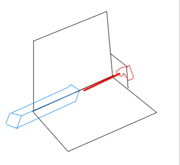

I'm thinking put the post in a V, either against a wall and floor or make a V out of 2x8s. Mount the drill at one end with the bit 4 inches away from the sides and parallel. Turn the drill on and slide the post down the V. Use a 4' bit and turn the post around to go from both ends. Like this, if it's understandable.
Red is the bit, blue is the post.
Oops, just realized your post is probably already in place. In that case perhaps you could build a similar jig that would slide down the post.
