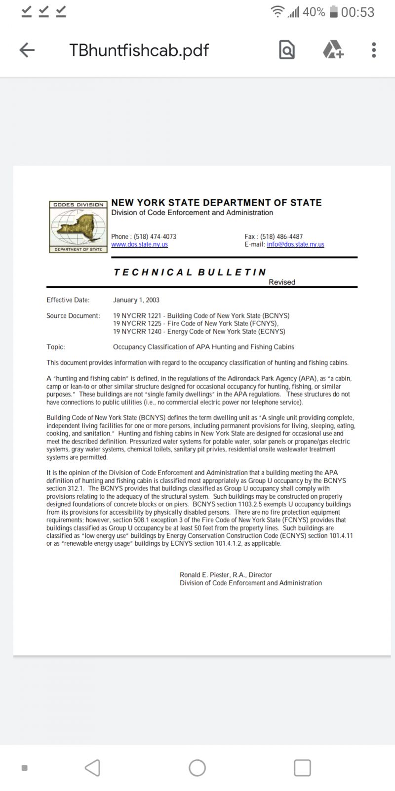

Here are some rules for APA areas for hunting camps
SIRHuntingAndFishin.pdfAttached file: SIRHuntingAndFishin.pdf
# Posted: 21 May 2020 07:46am - Edited by: Brettny
No where does it say in that document that you dont need a permit. It just states that they have there own specific requirements for that type of building...and there still regulated by the APA.
Follow those code numbers and I bet you find out more info on what they are expecting for codes.
O and we still dont know if this person is in the APA area.
xtolekbananx
# Posted: 21 May 2020 08:48am
I never said that he needs no permit. Only if he is under 144 sq ft. Just trying to help, in some cases it is easy to get a permit for hunting camp and stay off grid than call it a cabin and than they will require utilities. There are ways around it. I looked APA only because it is probably the hardest area to build when it comes to rules and codes. Well anyway good luck...
