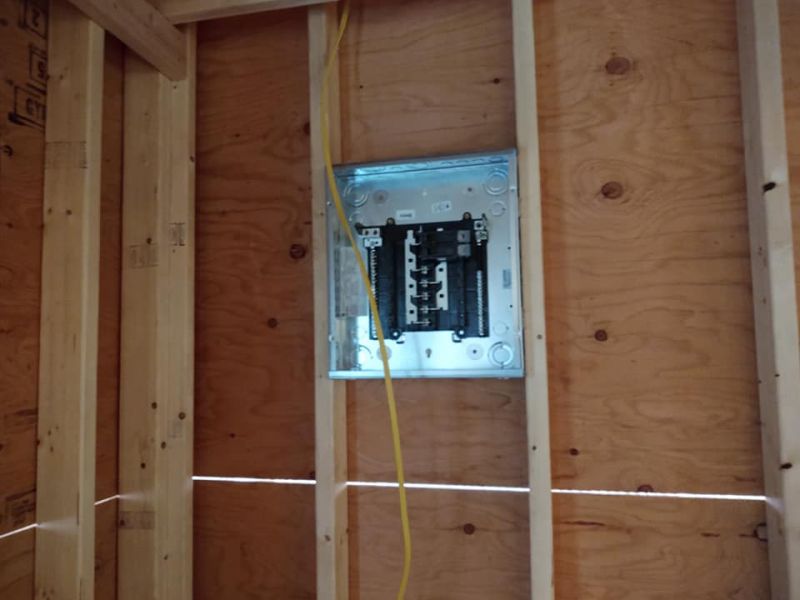

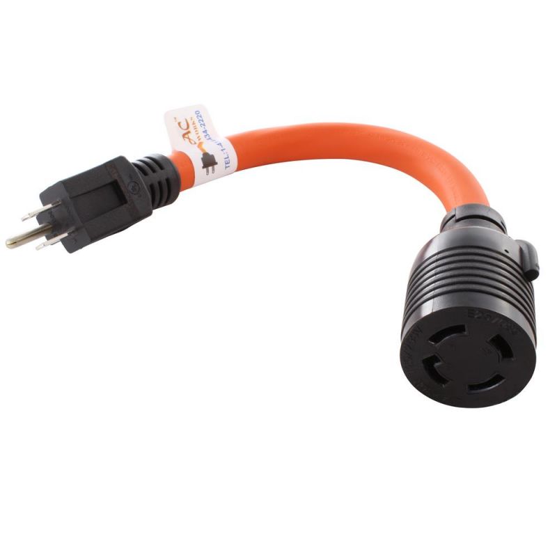

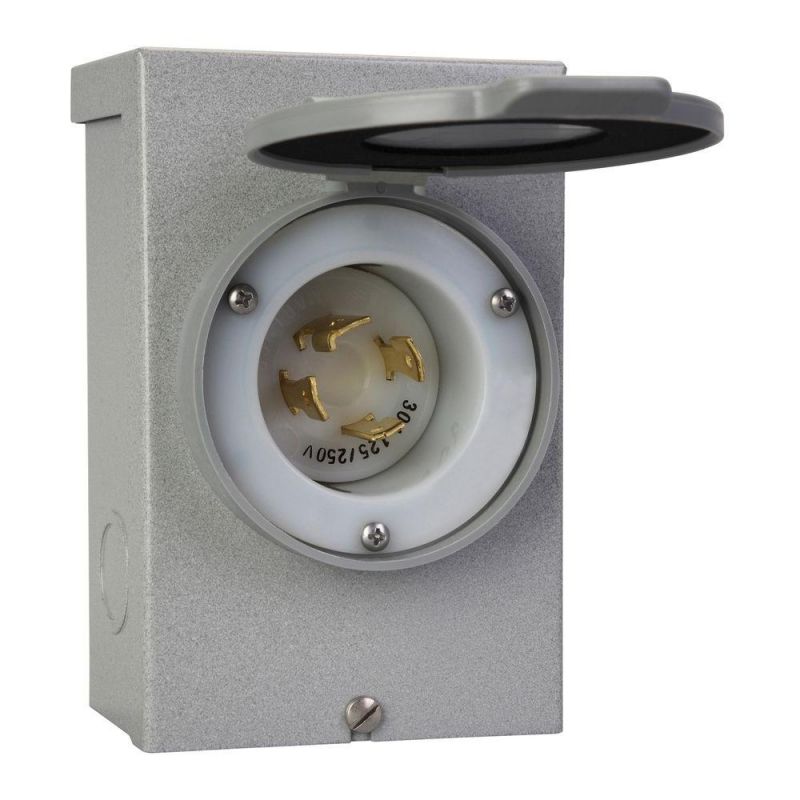

I am starting to wire my cabin to run off a generator. I purchased a L14-30 power inlet box. Its a 4 prong twist box. It will bring two 10 gauge power wires to a 30amp breaker. That should power both legs of the box. Problem is both of my generator do not have a 4 prog twist. So if I get a dog bone adapter will that only power one leg? Or will it work fine? Maybe I should just run a three prong 30amp and use a wire to jump the breaker. I am not sure at this point. Going up to work on the cabin this weekend. I searched the forums but didn't find a answer that was clear. Youtube was no help either. Thanks for any help.

Depends, is it a 120V or 240 3 prong twist? If its a 3 prong 240, still do both legs. Its line, line and neutral (so to speak) red black white.
If it is 110V, not the end of the world, just use a jumper to jump from one leg to other on input at inside of panel. I run mine on a Honda EU2000i and power up both legs. Just make sure jumper is sized for amps you are using.
# Posted: 21 May 2020 19:32
Unless your planning on upgrading your generator why not return the wrong plug you have a buy the correct one?
If your planning on getting a 240v generator just make a whip plug that will power both legs with 120v.
