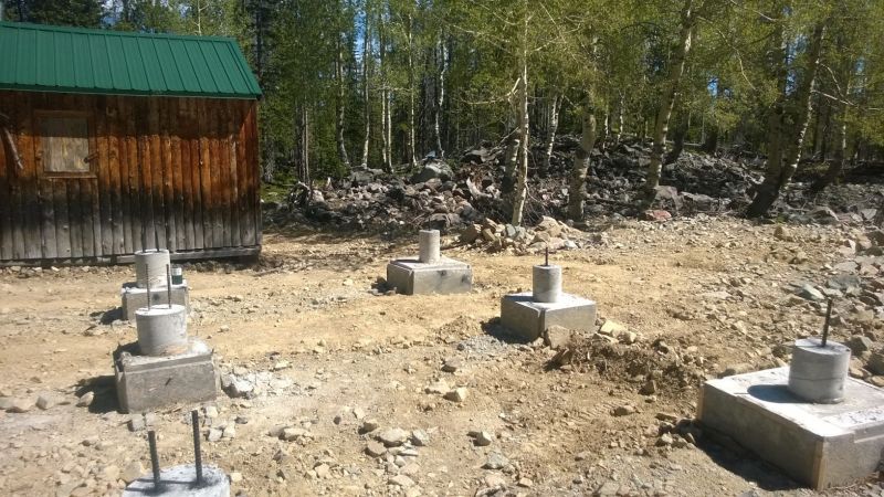

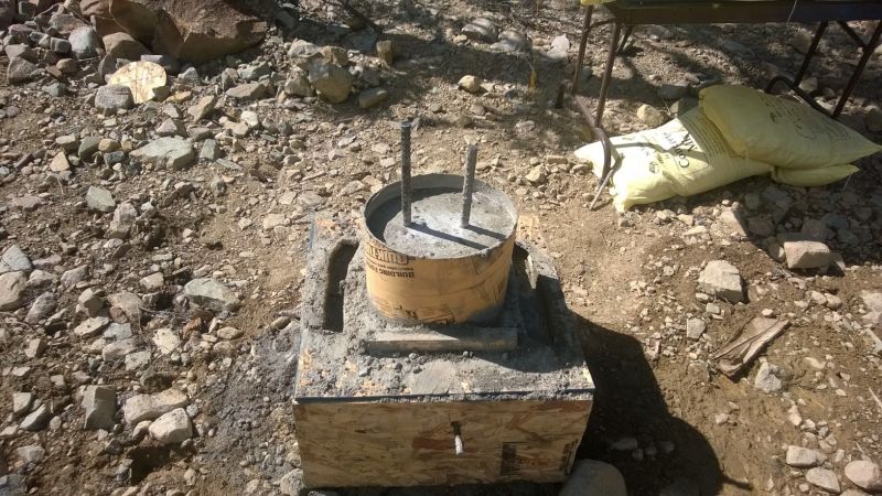

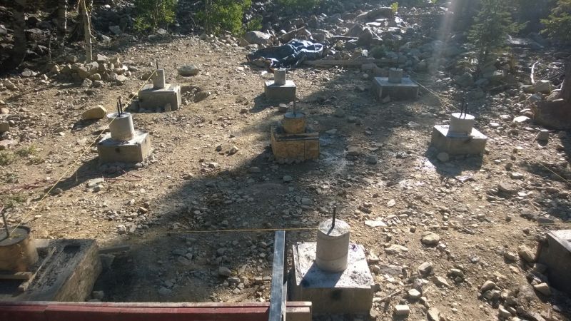

snobdds
# Posted: 10 Jun 2020 11:12am
I know where you're at. Been to foxpark a lot, pass buy it when I go to steamboat in the winter. I am on the north side of the snowy range between medicine bow peak and elk mountain. The sleeply side of the mountain, where you really don't see a lot of people all summer long.
This is what my engineer designed as a footer/snotube to hold the snow load. It's a sonotube inside of a footer. The snotube is suspended in the footer and caged in rebar. Very solid. sono_tubes_2.jpg
