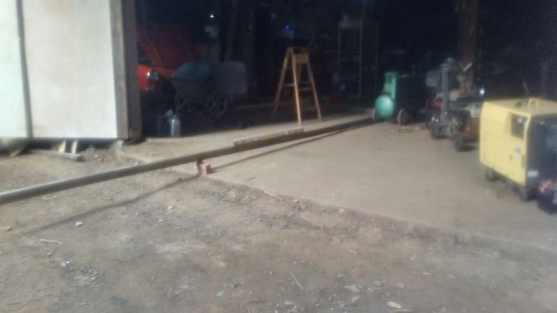

I built my new shop on top of an old basement. It was a drive through thing and the floor is sloped toward the driveway. It's not a big deal but I'm curious if I could level the floor without removing the existing concrete?

looking at your picture Paul, don't they typically pour like that intentionally to keep rain water out and to let any that does blow in run back out? i'm not sure I would mess with it.

Yes that's probably why it is that way, originally it was open, no door. And it hasn't been an issue for me but the new doors I made have a gap at the bottom about equal to the slope. I'm thinking I will just put some rubber strips (they swing out) at the bottom, just thought I'd look into it.
I suppose I could pour regular concrete with some rebar into the old concrete, get it up to under an inch and pour the self leveling over that but as has been said it would probably not be very durable.
