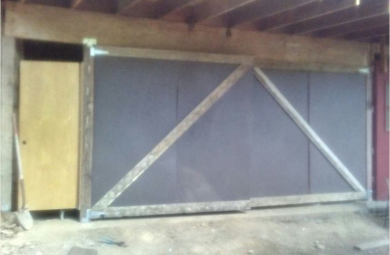

There's perfect room for an entry door left over next to my new barn doors, and as luck would have it I had a prehung exterior door in the shed. Want the hinges inside I guess, which means I would rather it swung the other way, although this works. The only issue I see is the top piece of the frame would take a bit of fiddling, is there some other reason you can't flip a door upside down?
Shop door, not the Taj.

I should clarify this frame has no threshold that I remember but yeah, the top and sides fit together nicely.
Actually having it swing out would be OK. If someone wants to break in it would be much easier prying the barn doors open anyway. Like most of our places you can make quite a racket before anyone notices.
