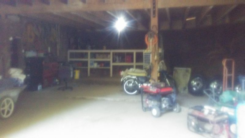

Just finished some shelving with 2x4 frame. I've taken to screwing most things together anymore, makes the mistakes easier to correct. For joist hangers etc. I've been using the Simpson screws with the hex head. Really nice, strong and don't slip out. Plus the long ones have a smooth shank long enough to go through a 2x and pull it tight to the board behind.
For countersunk I use deck screws. The problem I have is even with 3 1/2" length the smooth shank doesn't make it all the way through a 2x before it stars to countersink, so to get it to pull the board behind tight I have to bury the head way down, and even then it often fails to draw the back board in.
I've looked though all the types at my local hardware store, am I missing something?
