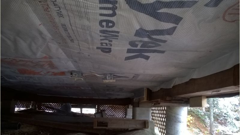

rpe
# Posted: 19 Jul 2020 10:45pm
We put R24 Roxul batts in from underneath, covered with a layer a house wrap, and then put the 1/4" hardware cloth over that. It worked out really well, and there have been no rodent issues so far. The house wrap does a great job of holding the insulation up and in place, and allows the hardware cloth to be installed without constantly grabbing and pulling on the installed insulation.
rpe
# Posted: 19 Jul 2020 10:46pm
Under-floor pic
FloorInsulation
FloorInsulation

Quoting: rpe
This makes a lot of sense, thank you. The hardware cloth grabbing on the roxul was a concern. Does your Roxul fill the entire joist cavity?
Quoting: Brettny
Any good insulation job can be destroyed by rodents if/when they find a way in. Try to really knock down the population, it's very hard to do this with simple snap traps. Also remember that traps in your building are baiting them into the place you want to keep them out of.
Absolutely. I'm in the process of sealing the cabin as tightly as I can, hoping to limit entry. Right now it's a free for all. 1/2" gap under front door, gaps in fascia, etc. In the meantime they have particularly enjoyed an insulated ceiling over a bedroom. Next project is to rip out an attic floor to remove the fiberglass insulation there. At which point I'll have a separate insulation thread of questions
rpe
# Posted: 20 Jul 2020 10:47am
Yes, we completely filled the joist cavity wherever possible. Our cottage was not professionally built, so spacing varied a bit requiring some trimming and stuffing of the insulation. The stapled layer of Tyvek held everything in place nice and neat, as some batts would want to slide out on their own. Roxul is heavier than fiberglass, and also doesn't compress as easily, so we found some batts would want to slide out unless held up via the Tyvek.
We then unrolled the hardware cloth and used roofing nails to cover the floor as a rodent deterrent. We had 2 ft or more of clearance underneath, so it wasn't too bad of a job.
