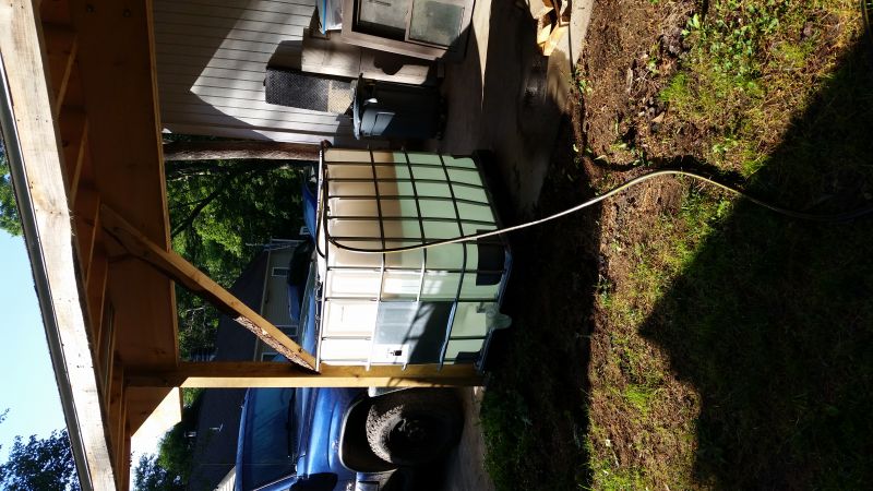

# Posted: 4 Aug 2020 09:12am
You will need to add angle braces, a wall or a combo of both. How you attach it to the cabin really matters too.
This is how my car port is framed, I didnt take this pic for this purpose though. The bottom of that 45* base has a 1/2in bolt through it and the post. The top is notched and through bolted 2x. I wish I used 6x6 posts for the vertical. I chose my main carry beam dimention because that's what size log I had. Didnt really made sence to cut it any thinner. Its 2 2x14".

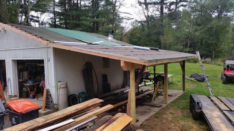

# Posted: 5 Aug 2020 05:59am
Mine is 12x24. The top is nailed/screwed into the roof rafters over the top plate of my garage. It has no walls except for the one that is the garage. It has a shingle roof so plywood sheething. Prior to the angle braces on the two end posts it racked quite a bit in line with the posts. Now it dosnt move.
I really like having open walls on 3 sides. Theres been many times I have come in the long side with my tractor bucket. Leaving both ends open makes for easy acess and not having to move something to get to the back...there is no back.
# Posted: 5 Aug 2020 06:11am
It's a pretty simple structure. 2x6 rafters over a beam that's over posts. Mine is on a slab but could be on sono tubes. Put a gutter on it, it really helps with water splashing under the roof. Even durring this tropical storm only 2ft in the concrete was wet. I have 12in overhangs on the sides and I think 18in on the bottom.
If I needed to lock things up I wouldnt build a structure like this. How ever it is great for equipment storage, firewood and just odds and ends you like to keep dry or snow off.
