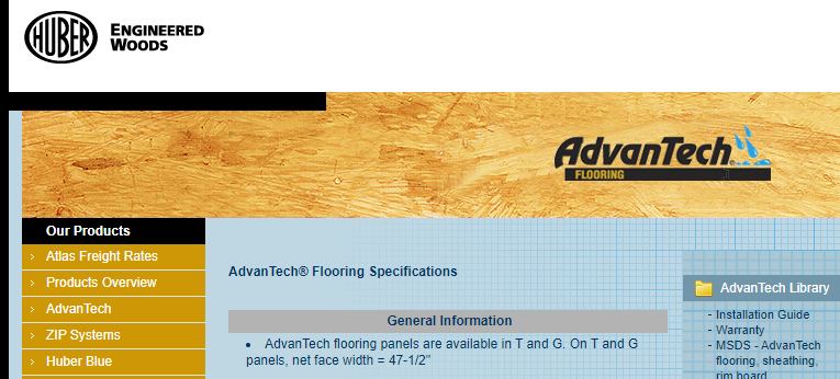

# Posted: 6 Aug 2020 12:57pm
From their website...
# Posted: 6 Aug 2020 01:12pm
You lose 1/2" on the width with the T7G joint. Length is fine; you space the 8 or 16 ft length joints with an 8D (1/8") nail.
Measure the floor width first and figure out how it covers. Often you end up cutting off panel width on both the start and finish sides.
