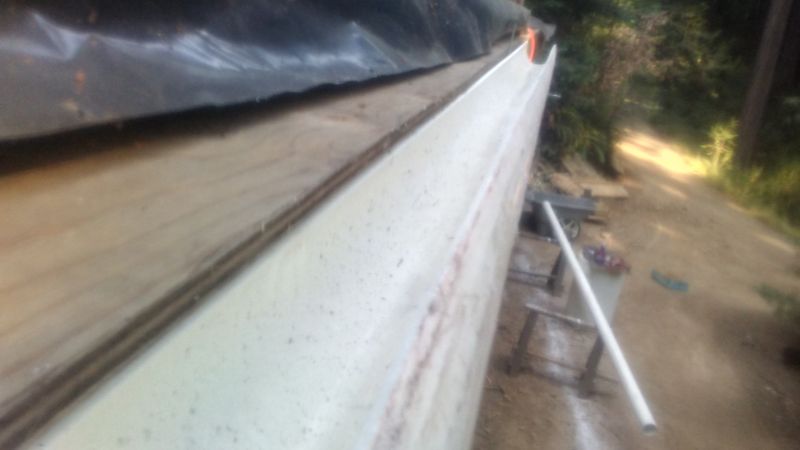

More blurry pics (but I got my new phone yesterday!).

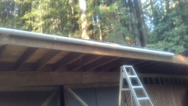

Remember my mile of 4" PVC pipe score? Well I'm down to my last 500 feet, and finally thought I found a use for some of it. My plan is/was to cut a slice out of it and use it for my rain gutter. Here is a test piece I tacked up, what do you think? Can't say I'm enamored with the look of it but it should work. Or should I just use this regular metal gutter for sale down the road? Gutter isn't expensive, just would like to use what I already have. Plus with 100' of roof line these 20' lengths would be easy and I could just glue them together.
# Posted: 1 Sep 2020 07:17am
I have never used PVC for gutters but I bet it's tough as nails. However metal gutters can be very thin and not take a ladder very well at all. I have had to replace some that where less than 7yrs old.
The PVC looks pretty marked up. You could sand it down or even paint them if you wanted something that looked better.
# Posted: 1 Sep 2020 07:40am
With the curve in the pipe can you get it to sit tight or is there a gap that will collect leaves and pine needles
If so I’d sell it and buy real gutters
# Posted: 1 Sep 2020 09:32am
Thanks for the input guys. Good point on the ladder, crushed a metal gutter or two myself. This PVC is thick, bet it could take it. Yes, would have to paint it, no biggie.
I originally cut a 5" hole in a 2x6, cut it in half through the hole, thinking I could nail them to the fascia and set the pipe in the half circle. But when I put the test piece up I just ran a screw through it into the fascia, about an inch down from the top of the PVC. Holds it tight against the fascia, no gap. Doing that every 2' might suffice, and if it did sag I could add the supports.
The slice I cut out of the pipe is less than half, closer to 1/4, so the outer edge of the gutter could stick up above the roof a bit. Uses twice as much pipe, but I have plenty..

I'd paint the side facing out black or dark brown and call it a day. I don't think it looks bad and I bet it holds up better than a lot of cheap material.

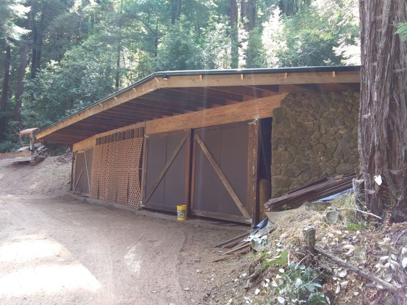

So I went with my PVC pipe stash, cut 4 inch wide slices out of it, painted it black (black ABS would have been nice..), screwed it to the fascia and added support blocks. Just need down spouts, culverts across the road to the creek, some road base, finish the front wall and doors...

Thanks Skoot! Yeah the best part was reducing the stack of those 20 footers down to a couple dozen. I've moved them so many times I could probably go out for olympic pole vaulting.
Trying to figure out down spouts. The doors swing under the outlets (at the two corners), about 3 feet below them. Diagonally back to the wall I guess..

Thanks Kin, good advice on the down spouts! I hadn't thought much about it yet but you're right, with the redwood duff I get they will easily clog if not right. And it's a 6-8' horizontal run back to the front wall, and only about 2' drop to stay above the doors.
Hmm, now I'm thinking maybe one of those chain things straight to the ground, I can move it when I want to open the door past 90 degrees.
I have time, I figured I'd just put 50 gallon barrels under the outlets for the first couple rains and see how it does.

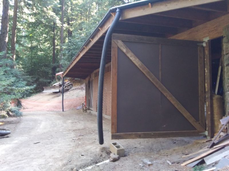

Anyway, I am ready for rain, gutter wise. I couldn't come up with an attractive way to get from the gutter to the ground, the door swing is in the way to go back to the wall. So, I have this movable flex pipe, for the rainy season. I don't normally need to swing those two end doors out that far but don't want to lose the option.
