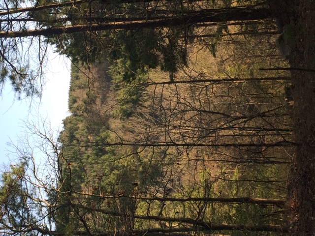

SJ76
# Posted: 3 Sep 2020 04:19pm - Edited by: SJ76
This here’s the spot
