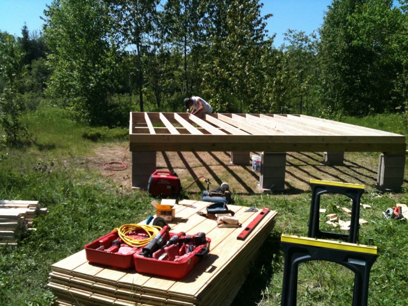

I live in Minnesota and used Patio blocks then put 8" blocks on top then shimmed everything to get it level, everyone around there does this then dont have to worry about frost heaves.
