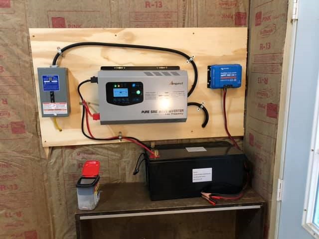

I guess I am different than some folks, I try to oversize my system to meet futer need vs. having to rebuy to upgrade. I went with inverter/ charger and lith. battery. I hard wired it all in in our 12x20 "shed" cabin. I have solar and run the genny in evenings if we need extra power for tv- but it will last for 2 days just off battery. Photo of my system as I was putting it in.
