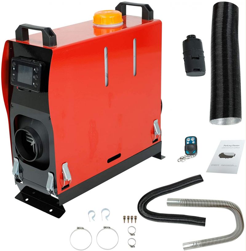

We thought about a woodstove for our 10x10 greenhouse but without heating a water tank or some other mass, it didn't seem practical for us. I'm not going down to stoke the fire at night.
We have insulated with rigid foam on the north side/roof and partially on the side walls on the east and west. We just cut foam blocks for the upper/lower vents that can be put in or taken out as needed.
We are getting ready to install a 5,000btu diesel heater. It is an all in one unit with a 5L fuel tank. It will exhaust outside and can draw fresh air from outside...we will probably recirculate inside air.
I'll report back later in the year how it is working or not.
THIS is the one we got.

I got the diesel heater installed yesterday. Of course being a cheap Chinese unit (though I read the main components are nearly identical to Wabasto) it didn't work until I fiddled with it. A little plastic doohickey of no noticable function had jiggled loose in shipping and jammed up the fan. Once that was put right away it went!
It was 35* in the greenhouse this morning at 6am so using the remote I stepped onto the back deck and switched it on. I have it set on the lowest setting... 9* C... it always kicks on high until it reaches the desired temp then drops to low. It raised the temp from 35* to 42* in a 10x10 plastic covered greenhouse.... (N, E, W and north roof are covered with 1" foam...) in roughly 30 minutes then set there purring away until I shut it off. I'm going to set the timer tonight to come on by itself at around 6:15am so I can check that this function works, then probably set it to kick on in the early morning hours when we start freezing hard at night.
So far so good!

Well the diesel heater is working pretty well in the greenhouse. The only problem was two mornings ago I got up at 6:15 and checked the greenhouse temperature... 26F, burnt the tomatoes back pretty badly. I fired up the heater- it has a remote so I can do that from the house, it took the temperature from 26F to 40F in less than an hour and then held it there. I was up this morning at 2AM and looked at the thermometer for the greenhouse, it was 34F so turned on the heater. When I got up this morning at 7AM (I never sleep that late... it was nice!) The greenhouse was 40F and it was 29F outside... was supposed to be between 13F and 20F... I guess it decided to be warmer. Anyway I do think these heaters will keep a greenhouse warm and extend the season, but there is one problem...
The controller that comes with them. Some are programmed with a timer that can be set to come on/go off at specified times, this can repeat daily. Great! However, some come programmed with a countdown timer... you set it to come on at the end of the specified countdown, you have to do that every day. Yuck.... and yes that is what mine came with. So I looked on Amazon, found one that someone in the reviews said they could set specific on/off times (they are not specific in the product description as to how it is programmed)... ordered it. Yes $25 later I have another countdown timer. Crap! The biggest problem here is they are random... there are 2 main LCD controllers and neither one of them has a guaranteed on/off timer programmed in. Either one of them could be countdown OR on/off timer... no one seems to know how you can tell which you will get until you plug it in. Crazy!
There is an aftermarket controller built by a guy in Australia that is the bomb! It does everything but back flips. It has several timers built in, altitude adjustments, and a frost protection function. But it is about $130.00... and I paid $139.00 for the heater! That said, Wabasto and Esparr diesel heater are like $600.00+ and I read the controllers they come with are very limited... the Australian made controller - called the Afterburner- is far better. So, since the cheap Chinese heaters are basically an exact copy of the high dollar heaters... even if you bought the Afterburner controller and a Chinese heater you would still be into it for around a third of the cost. Looks like I'm going to end up getting an Afterburner controller for next spring... too late this year, the tomatoes look pretty rough as do the squash and cucumbers. Next year will be different!

Can you not control it with a thermostat? That's what I do. I bought a thermostat and mounted it to the wall in the middle of the greenhouse (the heater is at one end). I set it so the heater will kick on when the temperature in the greenhouse gets to around 40 degrees.

North.... yes and no on a thermostat. The Chinese diesel heaters have a thermostat of sorts in their LCD controllers, but, they are designed to be on continuously. When they hit your set temp they then idle to maintain the set temp. They are turned on or off manually. The Afterburner, aftermarket controller does have a thermostat that will turn it off and on. The frost feature/thermostat of the Afterburner and the altitude adjustments make it appealing to me. Living at 9,500 feet we do not get a clean burn with any petroleum burning stove unless you can adjust the air/fuel mixture. I have done this by decreasing the fuel at the idle setting while increasing the air intake speed.... but I'm just guessing at it. I have over 15 hours of burn time on it so I think I have it set ok... i read where others have experienced sooting/shut down after just three or four hours.
