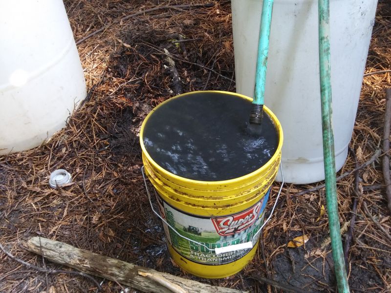

I was using my well water today for various stuff and test filled a 5 gallon bucket. Minute and a half. I guess that's OK. But the water is not crystal clear, have a look. You can skip to the end, nothing exciting going on..

I've been using the well water for washing and boiling coffee water for several years, I bring in drinking water. Had it tested in 2017, E coli negative, total coliform positive. I tried a self test kit, had a lot of minerals but I forget what. Smells like sulphur, especially at the start.

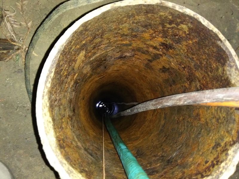

Anyway, it sits on the forest floor, the water table is 15-20 ft. below and the well goes down about 45. It has an iron 8" casing. The water has always been very black, but longer pumping times clears it up some. I have suspected for a long time there must be a crack or corroded casing.

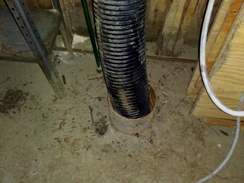

So...about two weeks ago I pulled the pump out. It was solid black. I had some solid 6" id corrugated plastic drain pipe laying around, fit nicely inside the casing. So I shoved it down all the way until it hit bottom. Put the pump back in and started pumping. The water soon got much clearer, and, as I went the drain pipe sunk lower and lower. I suspect the silt at the bottom is coming out. The pipe has gone down about 4' so far, went down about a foot today, I ran the pump for an hour or better. I have the pump about 10-15' from bottom. I pulled it out again and it is clean stainless steel again. Water supply seem unlimited.
I'm hoping I can keep going and the plastic pipe sinks to bedrock and I get real clean water. I know it's a bodge but it sure is better than it was. My water tank is close to empty so I will need to fill it soon.

Is that ADS pipe perforated?

Paulz they make well casing seals that you can put in your self. There basically a big sand point with rubber gaskets and pvc pipe that screws or glues into it. This would be like getting your well reclined. But first I would make up a simple air pump and get it all the way to the bottom of the well and pump the crud out of the bottom. Google air pump, very easily made and I bet you have 3/4 of the parts needed alreaty.
My well in my house is actualy in the basement of a cottage on the property, it was an old barn built around 1931. Its 50ft deep, I never run out of water but my well casing is also failing. My static water level even durring a drought is 10ft. My neighbors have wells 250ft(he runs out) and 600ft (they have sulpher)
The rotten egg smell can also be from iron bacteria. Shocking the well and useing a carbon filter could help that aspect of it.

How old is that garden hose? The black rubber may be coming off the inside. They make food grade hoses.

Not perforated.
I will check.

^^^This or a combination of sulfur and iron bacteria. Iron bacteria will generally turn things rusty brown whereas sulfur/sulfur bacteria will often leave things black. Neither are really harmful but not pleasant either. A city near where I worked in Oregon had to pig their lines regularly to reduce iron bacteria... water would be a murky brownish... horrible looking stuff that came out when pigging.
Quoting: darz5150
Have you ever shock treated your well?
This can help with sulfur bacteria but is often short lived. If you have alkaline water... in a higher Ph it doesn't usually work well. Another small town near where I worked in Oregon had a horrible issue with sulfur bacteria... alkaline water so even shocking the well with CL2 was ineffective. The locals were used to it but it was terrible tasting water!
A filter system as Brettny suggests is likely your best choice for reducing odor/taste. Again the sulfur or iron bacteria won't hurt you.... hydrogen sulfide gas if the well produces a lot can.
Edit... both can eat away at the casing so re-lining the well might be in order.

I would get that ads out of there. It could end up causing more problems if it drops and blocks your screen if you have one. If your well is just drilled into rock the screen that Brett suggested might be of no use because rock wells feed from cracks in the rock into the bore hole. I would blow it off with air as a fist step. I have used my 185 cfm compressor with good results. Most people don’t have one but you could easily rent.

Today I made up an air hose attached to two 4' steel stakes, removed the plastic pipe, put that down along with a utility sump pump sitting on the bottom. Worked that for a few hours. Removed and put the well pump back in. Still pumping black water.
Might be time to call in a pro.
