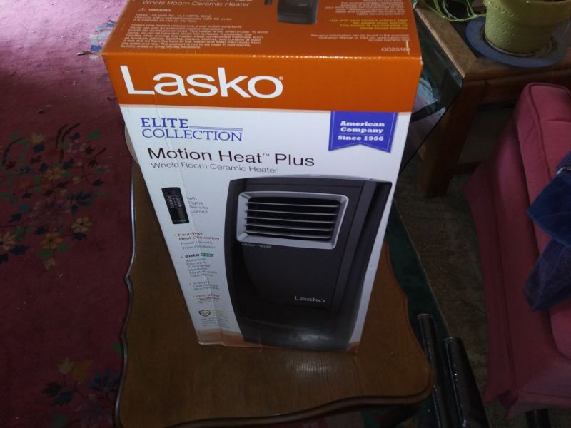

I sold a motorcycle for 5k yesterday so I splurged on a $70 heater at Costco today. But I'll save the receipt..

So about a week ago I plugged in the heater I bought at Costco (pictured above) in our bedroom, and have used it a half dozen times. It has a remote. I didn't build a fire last night knowing we were heading to the cabin this morning. Pretty nice turning it on this morning without getting out of bed. The heat is noticeable (not helpful) right away, and a half hour later felt warm enough to get up and move around, and fire up the wood stove.
It's a handy thing, glad I got it. I have only run it about an hour at a time.
