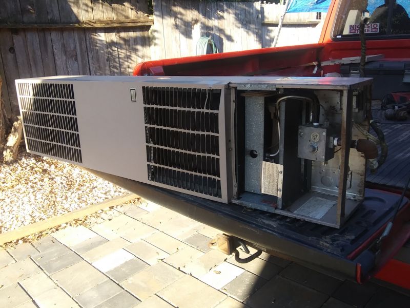

I'd like to use this old ng wall heater in my shop, on propane. I know it needs a smaller orifice, somewhere. And maybe a new valve?
Worth it?

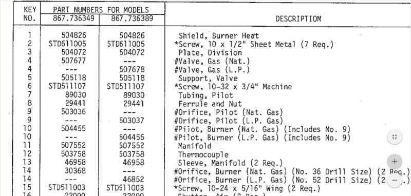

# Posted: 13 Oct 2020 08:25pm
Thanks ICC. Found a user manual online, it shows a different valve for LP. This is an old unit but it looks like universal type replacement valves are available for $50-$100. Then the orifices..
Not sure it's worth it.
