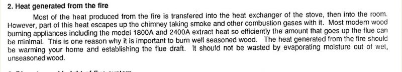

Looks like I'm in the old stove category. Is a smoke shelf the same as a baffle plate? i have two Arrow stoves, one at the cabin and one in our house bedroom. The have a 'heat exchanger', it's a steel box within the outer box, and a fan blows the air in between out the front. And a baffle plate. No catalytic converter, no reburn tubes. I see online some guys are able to add the tubes to old stoves.
I wonder how much more efficient a modern stove would be? I have gone up on the roof with a fire going and it's pretty darn hot.
Excerpt from my manual
