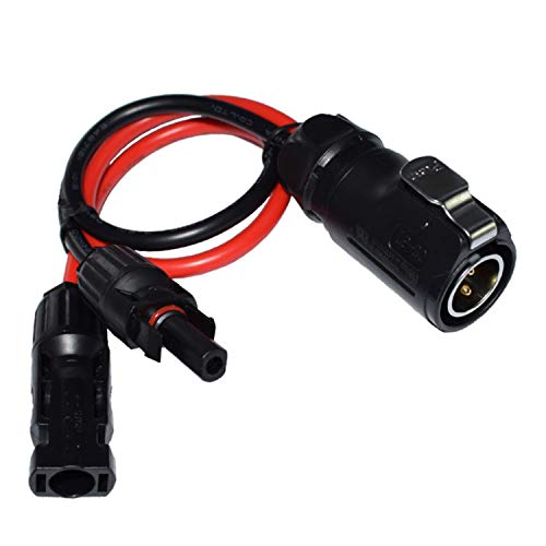

Just searching around and wondering if this is what you have... the picture is of an adapter so standard MC4 cables can be used.
The Furrion solar port.... is a rare two pin port, not found on most solar panels. You can probably imagine why they would do this (hint: they make proprietary solar panels that use this port).
A link to the article. HERE
