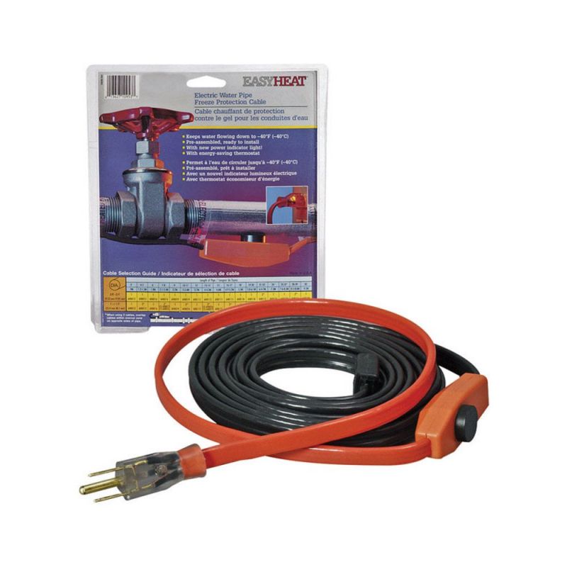

Going into town tomorrow so hoping to find a 6' heat tape to put on the lines in the water entry box. I see a 6' heat tape only draws 17amps... the one in the pu ml p shark pulls 84amps, BUT they have thermostats so it is not a continuous draw.

Heat tape off a battery bank..I would def make sure you insulate over the heat tape. Where is the thermostat on these? I have never been in a situation where I needed heat tape.

Yeah I had my doubts too but we have a 12kw lithium battery bank. The long heat tape in the pump shack (again this is a big box) isn't draining the bank badly overnight, maybe added .1-.2 volt drain. I can live with that. It was 5*F last night... brrrr! Yes.... we wrapped foil backed fiberglass pipe wrap over the heat tape. Interestingly when we started our investigation to where the pipes were frozen yesterday, after taking the 2" rigid foam from the box and lifting the fiberglass bats out, it was fairly warm in there.... pretty much knew right then there was no freezing in there.
The thermostat is the little black "button" just where the actual heat tape begins. This is placed against the pipe, taped down to make contact. Turns on at 38* off at 45*. See picture.
