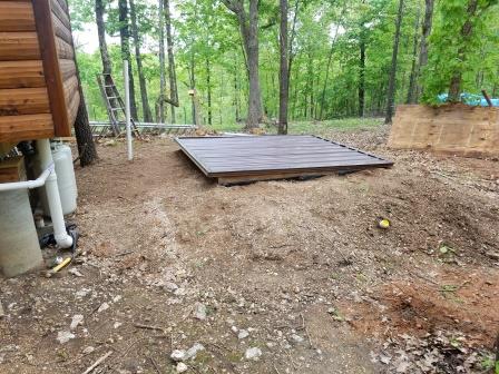

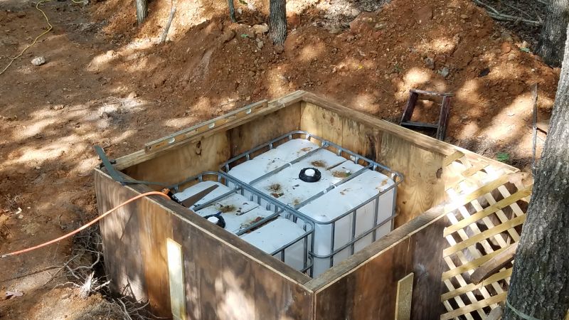

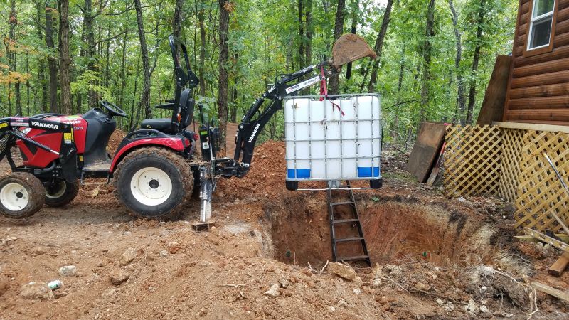

Hey MOHunter, I'm in Dent Co. I used two 275 gal IBC totes (food grade) for my cistern. I buried them at 4' deep. Lined the sides with foundation plywood. I have an un-insulated plywood top covering it. I ran the water lines at 18" into the cabin. I use gravity to drain the lines back into the cistern when we are not out there. Going on our 3rd winter and never had an issue with freezing.

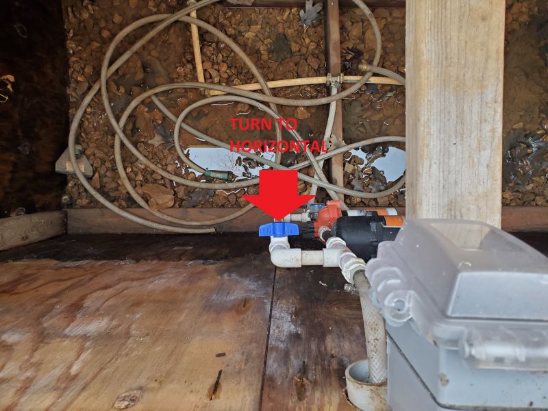

Hey MoHunter, I have the pump in the pit, 18" below grade. I have a by-pass valve that when opened, allows all the water from the cabin to gravity drain back to the tanks.
I have a 7 gal RV LP hot water heater, that gravity drains as well. You just need to plumb everything on the incline. And remember to open all the faucets.
Even though the "frost line" in MO is like 24" I did a bit of research. UM has a research center about a mile from me, the deepest frost ever recorded was 18".
We use the cabin quite a bit, end up filling the tanks 2x a year.
halfmarathondon
# Posted: 2 Dec 2020 03:47pm
Is the pic, you can see some water in the bottom of the pit. That was an issue. Running some drain pipe from the downspouts away from the cistern, fixed that issue.
