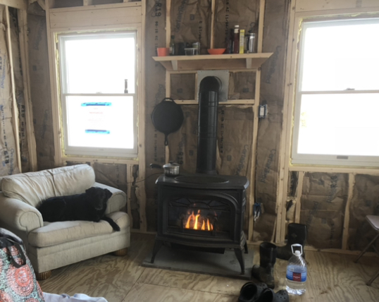

I 'know' its likely the perspective but the 36" clearance to combustable surfaces looks a might thin there, Gary. Good point on the ins. co.'s fire inspector would deny a claim no matter what. It is a 'shack', shed, not to code in any way, shape or form. You know, the same kind of structure (even better than many) that families were raised in pre WWII and better than millions of people around the world today live in. Still, safety is paramount. Ive lived/survived a lot in my almost 68years and being engulfed by flames is thankfully not one of them. Those little direct vent cast gas stoves have the look to match our place, the more modern tin boxes not so much. Ive got a lead on a used Jotul Lillehammer(sp?), have to find out if it is LP or NG. Sadly it is only about 18K btu (wish it was 30K'ish and Ive read doesnt have a heat exchanger).

# Posted: 13 Dec 2020 02:17pm - Edited by: Gary O
Quoting: gcrank1 I 'know' its likely the perspective but the 36" clearance to combustable surfaces looks a might thin there, Gary. Regs get a bit nuts And, me? Well....I'm a renegade
So regs be damned
That Earth stove just plain rocked We cooked all our meals on it
I knew the clearance issues, but the cabin was small. That miniature wood rick was never an issue. Hell, if the wood was icy, we'd even put some splits on top of the stove for a bit
I absolutely oved the functionality of that cabin
