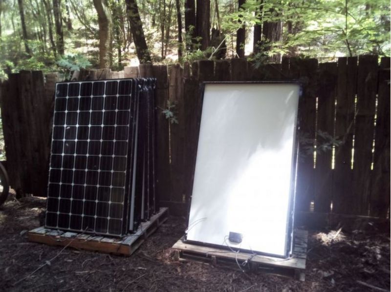

Of the 30 used panels I got, I have installed 25. They have all had equal open circuit voltage when I tested them. I saw a chart somewhere showing average degradation over the years, it wasn't a lot, couple percent a year.
