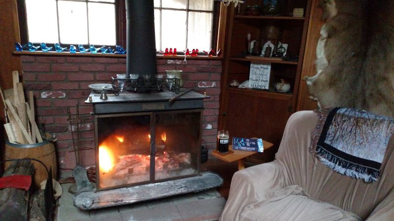

This is probably a stupid question, but the extent of my wood heating experience is the stove that has been in our cabin since we got it 15 years ago. It was built as a summer cabin (drafty, and no insulation), but we enjoy the occasional winter weekend if it's not too cold.
The question is, when you arrive to a cold (say 30°F) cabin and light the wood stove, how long before you feel comfortable hat near the stove, and how long until the entire room is comfortable? I realize there are a lot of variables, of course.
Our stove is in the 18x18 living room, the 18x8 kitchen is through an archway. Two bedrooms off the living room are left closed off in the winter, and our bedroom off the kitchen has its own heat (antique coal stove). The wood stove is an old (I'm guessing 1960s or 70s) "Early Times" brand and probably very inefficient, basically just a steel box.. but I do like the view of the fire through the large glass doors.
It's at least a half hour or an hour before I can warm my feet sitting right in front of the fire, and another hour before the room is comfortable... then it sucks wood, it'll only go for a couple of hours. Fortunately the coal stove in the bedroom keeps us warm all night, just gotta restart the wood stove and let it warm up while we eat breakfast in the bedroom.
I'm thinking something more modern might perform better, though. A decent size window is a must, though, seeing the flames is a big part of the cabin ambience.

Looks more like a fireplace than Woodstove. Can you even slow the burn down by shutting doors or closing a damper in the stove pipe?
If not your blowing more heat up the chimney than you will add to the room
Takes me a good 6 hours to make the cabin comfortable when I arrive in cold weather but after that I have to watch I don’t cook myself out of the place
Fanman
# Posted: 12 Jan 2021 10:11pm
No insulation. It does get quite comfortable, though, in a couple of hours. Maybe I'm not doing so bad. Yeah, I guess it's more of a freestanding fireplace than a stove. It's glass doors, it had wire curtains inside but I took them out. I'm guessing they were there so it could be used with the doors open or closed, with the doors open a lot more heat comes out but so does a lot of smoke, it's pretty shallow, so I only open them to poke the fire or add wood. The curtains made it hard to get wood into it quickly and cleanly.
I can slow the burn down some with the flue damper. There is a sliding plate under the doors with small openings, but the door gap is so wide (no seals and no evidence that there ever were any) that the sliding plate really doesn't do much.

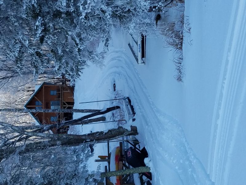

Thermometer inside the Northern Minnesota cabin said 15 degrees Fahrenheit when we got there around 1:00 last Friday afternoon. By bed time it was up to 55. Next morning we got it up to 65 and kept it there until we left Sunday afternoon.
The cabin is sealed up and insulated but is 24 by 32 and 20' tall to the peak. The wood stove is a good one but my wood is mostly birch, basswood and some maple that we took down to clear to build so it isn't the best and we use a lot of it.
gsreimers
# Posted: 13 Jan 2021 08:47pm - Edited by: gsreimers
Mama wasn't super happy, but it was kind of peaceful and pretty
