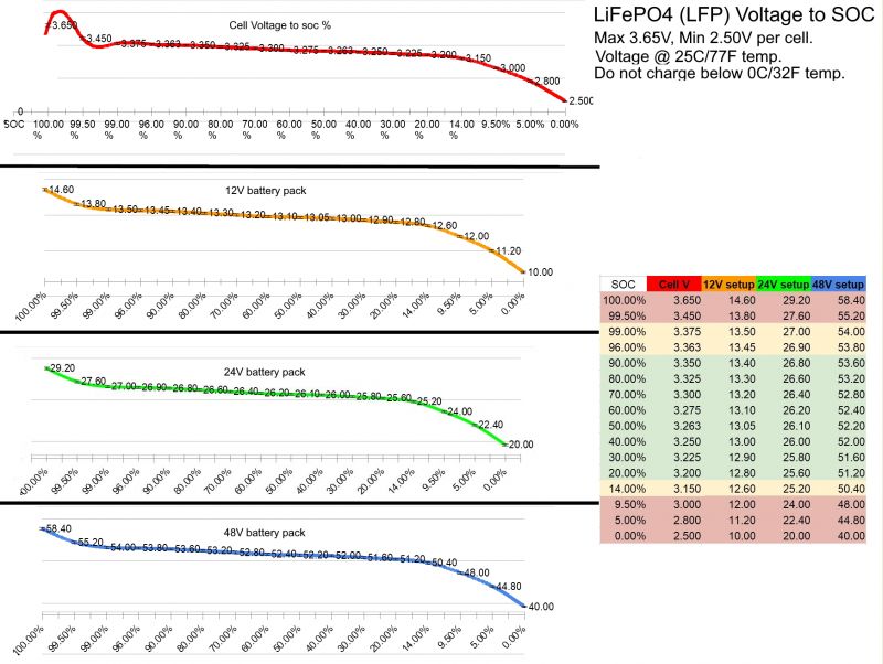

# Posted: 6 Feb 2021 03:53am - Edited by: Steve_S
Reply with much info to post and it gives me a 403 Permission denied. So OKAY - Fine. Tried 4 times and same shtick but I can post this... go figure.

LFP Voltage Chart
LFP Voltage Chart
# Posted: 6 Feb 2021 02:17pm - Edited by: gcrank1
That chart looks like with a 12v LFP battery I could keep the voltage between 12.4 and 13.4 and be in the sweet zone. Im used to that, I try not to go below about 12.4 (rested dod voltage) on my FLA.
