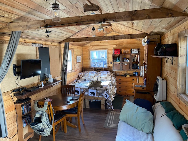

But in our 1 room cabin, I have 3 pendent lights hanging down the length of it. Each has a 60 watt equivalent LED bulb in it. They are on 1 switch. They are good for 85% of light needed- dressing, games, eating... For things like working on a small part at table or reading fine print, I used a small bright LED lantern. We also have a reading light at the head of our bed.
