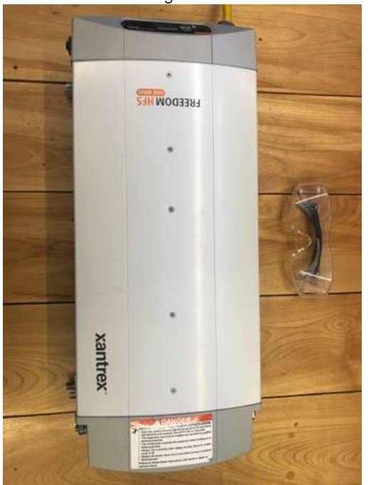

I'm considering a Xantrex Freedom HFS 2000 pure sine inverter charger. I see some of you are using the Freedom models. Amazon shows some less than stellar reviews..
Any good?

The Xantex I'm considering came out of an RV. They list for $6-800, I can get it for 3. Used electronics is a crap shoot. I've been mostly lucky, though haven't spend over $100 on any one thing. It has the same 2,000/4,000 rating but charges higher at 50a.

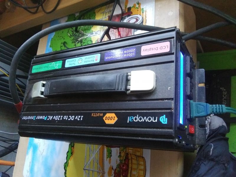

I've been using an inverter for a miter saw on my cabin trim. older, 600w MSW. A month ago I bought a 1,000w FSW Egg Foo, new. Tried it on the chop saw, cuts off the second I hit the trigger. Hoping it at least powers my new ceiling fan.

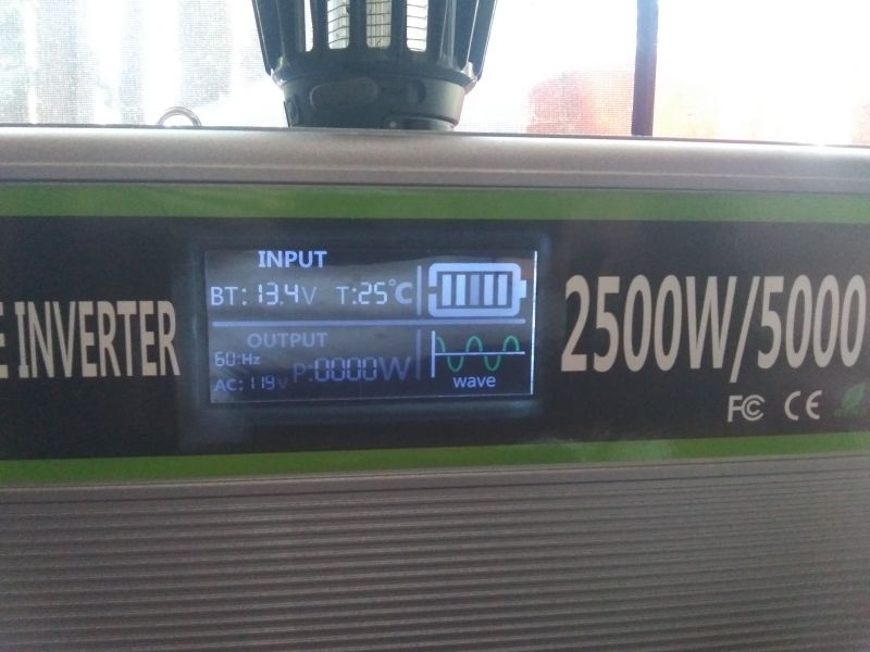

I'm going to submit a claim, I think, on my CCI (cheap Chinese inverter), Flazeum 2500w. It shuts itself off at anything over about 1200, no alarms or messages, starts again right away but will shut off increasingly rapidly if I try to go again right away. I bought the 3 year warranty through Allstate for an additional $16 off Ebay, we'll see what they say. Too bad, works great for the TV, fan etc..

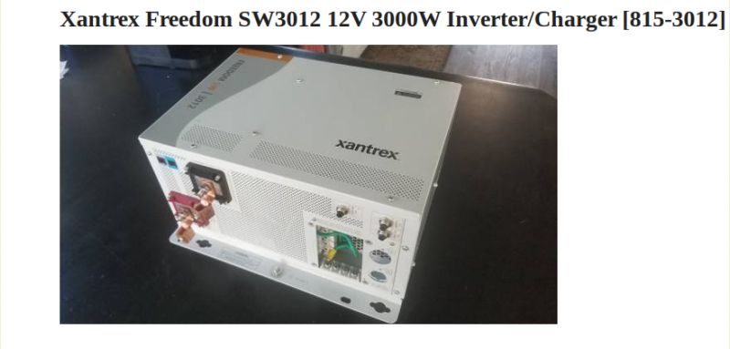

Anyway there's a new in the box but manufactured 2017 Xantrex Freedom SW3012 nearby I can get for about half price (1K vs 2K). An inverter/charger, which if I understand correctly I can connect to a generator in winter and charge up to 150A. And if it will handle even close to 3,000W it will be more than I need.
But, it's 12v, which is good for me as much of my cabin stuff (fridge, water pump etc.) is. I feel like I'm lagging behind not going to at least 24v, and I could run a 12v step down if I did got 24v.
Looks like this model is still being sold new? Maybe now there are better units out there for the same or less money?
# Posted: 27 Jul 2022 03:24pm - Edited by: ICC
I did not look back over this thread, but could it be shutting down because it cannot draw sufficient amps from the battery or batteries at the time it is being asked to deliver over 1200 watts worth of AC power? If so, a different inverter is not likely to solve the problem. Can you try out some other inverter for a big load and see what happens?
That is one of the reasons people use 24 or 48 volt battery banks. The mention of the 3012 Xantrex jogged my memory.
# Posted: 27 Jul 2022 06:18pm
If a cable end is bad it could be limiting the available current from the bat-bank; might be a good time to check ALL the cables and ends?
# Posted: 27 Jul 2022 07:20pm
The Xantrex is a Schneider product... think Square-D.... good equipment.
However, ICC may have hit the nail on the head, can your batteries, cables supply the amps you are drawing?
# Posted: 27 Jul 2022 08:12pm - Edited by: paulz
I have wondered about that..but the inverter has a display, and I've had my eyes glued it when it shuts down, never under 13v. The manual says a low voltage alarm goes off at 10 and it shuts down at 9. Never done either, but maybe that's only when not under load? The battery image does go down to about 2 or 3 bars under load.
From the battery bank I have 6awg cables, about 4', with a Victron low voltage cutoff set at 12.5 and a 50 amp breaker in the circuit.
Maybe I'll try adding second cables direct for a test.
