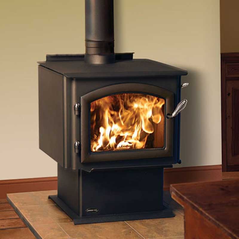

WILL1E, I have a Quadrafire in my house, they are build in my state, in fact, city of Colville WA, little town in the NE section, not too far from my cabin area and I am pals with one of their retired engineers, he is a ham radio operator and we chat in the evenings from time to time on the radio.
I didnt buy the optional fan at first, but added it afterwards, the fan kit was specific for my woodstove and is variable so you can turn it down. I also added a ceiling fan in the room where the woodstove is and it warms the entire house, I do need to keep all bedroom doors open, but its nice steady even heat.
Mine is the Millennial 3100 flat top. Same as picture below except the chrome parts or brass on mine.
Notice the shielding all around the back and sides, the blower runs air under those baffles and out, it picks up loads of heat and really warms the place up.
