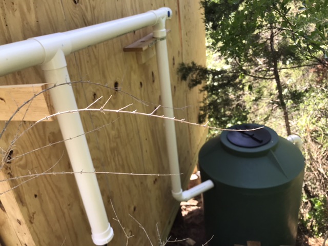

txDave
# Posted: 13 Feb 2021 09:34pm
If you have a relatively low planned water consumption, you might check out rain water harvesting from your roof, even though you are close to the lake. It’s generally cleaner than surface water. I set up a 300 gal tank, and feed it from about 180 sq ft of roof, and has kept the tank full even in a pretty arid area. Every 100 sq ft yields about 62 gallons with 1” rain. Simple cistern pump, filter, and uv sanitizer, feeds a sink and shower.
