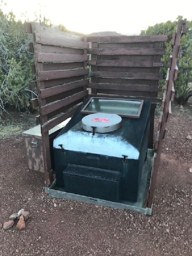

  Just got back from a 30 mile backpack below the rim of the Grand Canyon.   So the "toilets" on Horseshoe Mesa appear to be pretty much what has been discussed in this thread.  It was made by Romtec in Rosenberg Oregon.
  BTW this toilet has the best view of any toilet in the world!  Solar toilet
  |   Morning view from the toilet
# Posted: 7 Mar 2021 07:41am
  Maybe it is the perspective but that looks...awkward.
# Posted: 7 Mar 2021 08:39am
  Awkward... kind of but a relief after a few days squatting over a "cat hole!"
  Just interesting to me that this sort of composting toilet has a window to allow solar heat to evaporate a l o t of the liquid.  They add wood shavings to it to help the process along.
