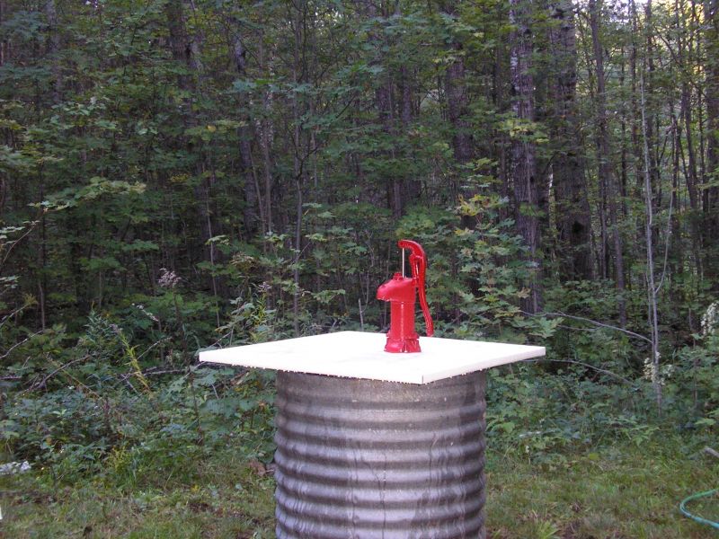

| tebrandon Member
 | # Posted: 14 Oct 2014 04:03pm Reply
 We have a blasted / dug well......22 feet deep - approx 3500 gal of standing water in aguifer around and in well - will be using submersible but also have a Beety Bros antique hand pump in operating condition for emergencies and/or rustic beauty. The pump is a lift pump having the pump cylinder below water. You don't have to manually prime the pump and it will not freeze in winter - bought on Kijij for $80 incuding all pipes and cylinder - a cheap fix for your well problems.
