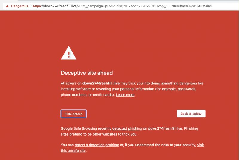

Unfortunately, it looks like their site has been hijacked... Trying to click on the "Shop" redirects to some suspicious site that Google is blocking with a big red alert. I guess I'll give them a call

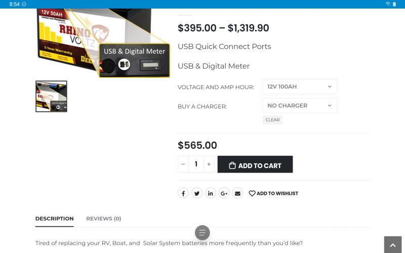

groingo
# Posted: 24 Mar 2021 04:08pm - Edited by: groingo
A minute ago it showed $565.00.
Also found no reviews in text or video on Rhinovoltz other than their website which also had no reviews.
Check return policies, you pay return shipping only after they approve.
Also, their website is a mess, latest price shown 12 volt 100 Ah was $565.00.

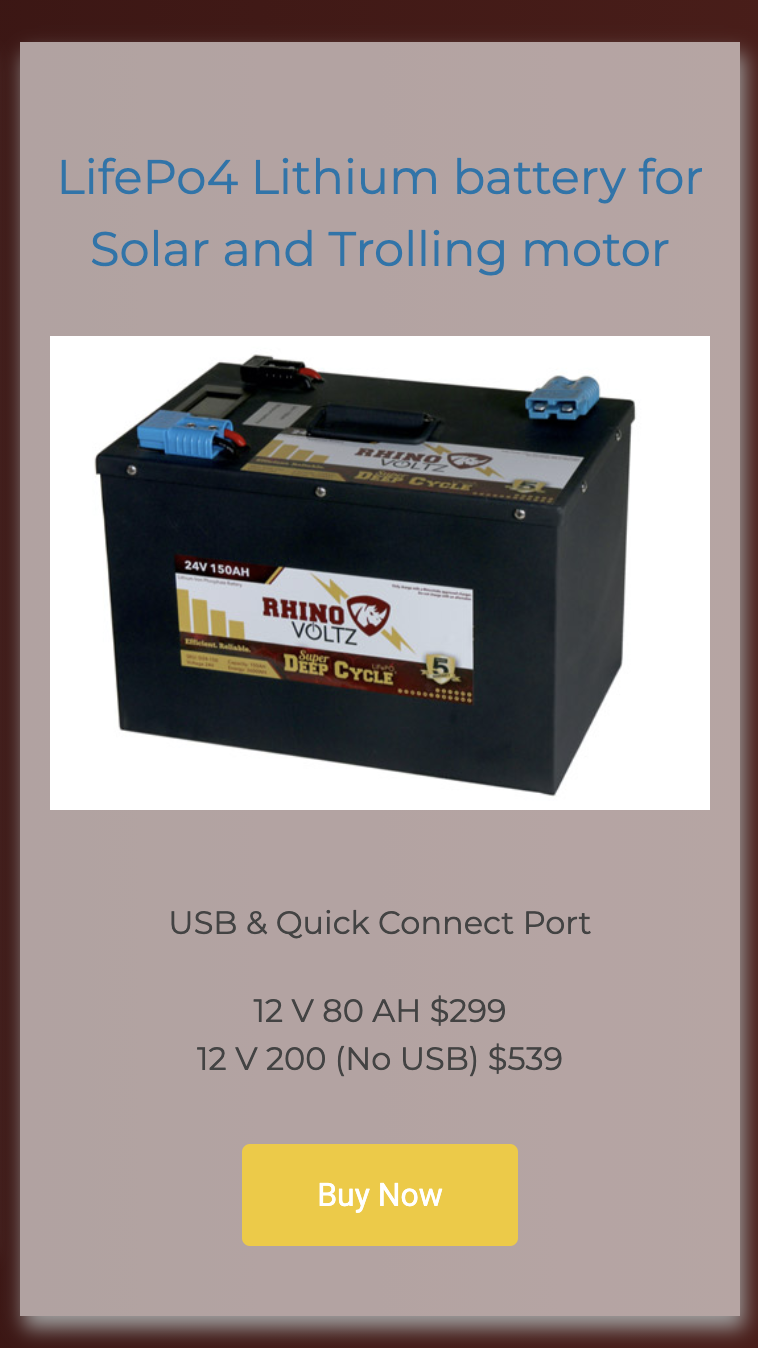

SCSJeff
# Posted: 24 Mar 2021 06:11pm - Edited by: SCSJeff
Hmm...
I'm still seeing $539 at the bottom of their homepage. See attached

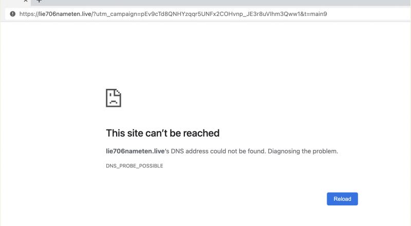

# Posted: 27 Mar 2021 12:32pm - Edited by: SCSJeff
groingo,
How did you get to their "shop" page?
Here's what I'm still getting when trying to connect to https://rhinovoltz.com/shop/ (also using the Brave browser):

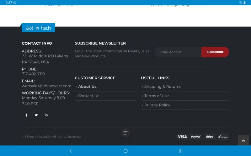

groingo
# Posted: 27 Mar 2021 12:55pm - Edited by: groingo
Maybe try clearing your browser history and cache.
Took this just a second ago.
# Posted: 27 Mar 2021 01:00pm
TBH, I would not go there... The warning flags are flying. LIO N Batteries (Lifepo) are apparently on sale again at Costco. There are other recognized know "brands" out there. 12V/100AH are quite a bit more common today than even 6 months ago. But not at $539 USD

SCSJeff
# Posted: 27 Mar 2021 09:27pm
IDK... I'm getting the same thing on Firefox and Safari too
