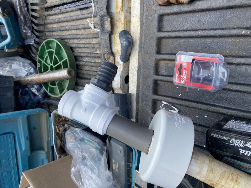

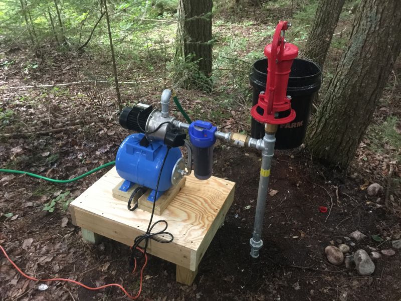

So I did this at my last property and the setup really well...however we weren't there much longer after i installed it to know how well it worked long term.
Anyone see any improvements based on your experience that you would suggest?
This time i'll build an actual pump house vs. just a platform.
I installed the union fitting near the ground for winter time so that i could crack that fitting loose to relieve the pressure in the vertical pipe so that the water would drain back down and not freeze the pipe in winter.
# Posted: 14 Apr 2021 04:26pm
Quoting: WILL1E
While a union fitting might still be a good idea in case you want to reconfigure things, just removing the housing on the filter should accomplish the same thing. Plus, you want to pull that off to get the water out of it anyway so it doesn't freeze and crack.
An insulated shelter over the whole thing would reduce the risk of an accidental freezing during the shoulder seasons.

# Posted: 15 Apr 2021 06:42am
I wouldn’t instal a filter before your pressure switch, if it ever clogged it can cause your pump to dead head.
WILL1E
# Posted: 15 Apr 2021 07:54am
Quoting: NorthRick
The check valve prevents that from working.
Quoting: Irrigation Guy
But how else do i ensure no particulates go into the pump and destroy it?

Irrigation Guy
# Posted: 15 Apr 2021 11:04am
Quoting: WILL1E
If you use a decent pump it should be able to handle a bit of debris. If you have so much that it is damaging impellers there is something wrong with your well
# Posted: 15 Apr 2021 12:16pm
Usualy the sand point at the bottom would filter out alot of the junk that would damage a pump.
You should change one of those filters over to a ceramic one so you could drink the water. Or add a UV light after the filter.

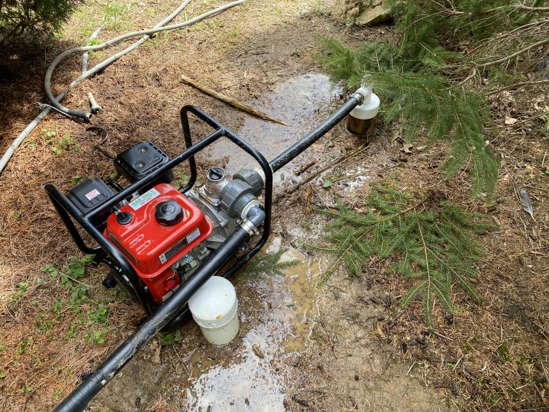

Irrigation Guy
# Posted: 18 Apr 2021 10:53am
On a related topic, a little project for the the farmer yesterday. He has a remote field where he grows tomatoes which had a submersible well pump that got power from the neighbor who he paid for use. The neighbor ended up having a stroke and hasn’t been quite right since. He somehow got it in his head that the farmer was taking advantage of him and cut the power to the pump. Farmer even offered to pay $1000 up front but it fell on deaf ears.
luckily groudwater in only 5’ down so I was able pull to the submersible, put foot valve on the drop pipe, and set him up with a trash pump to supply his drip tape. Not the prettiest install but gets it done.

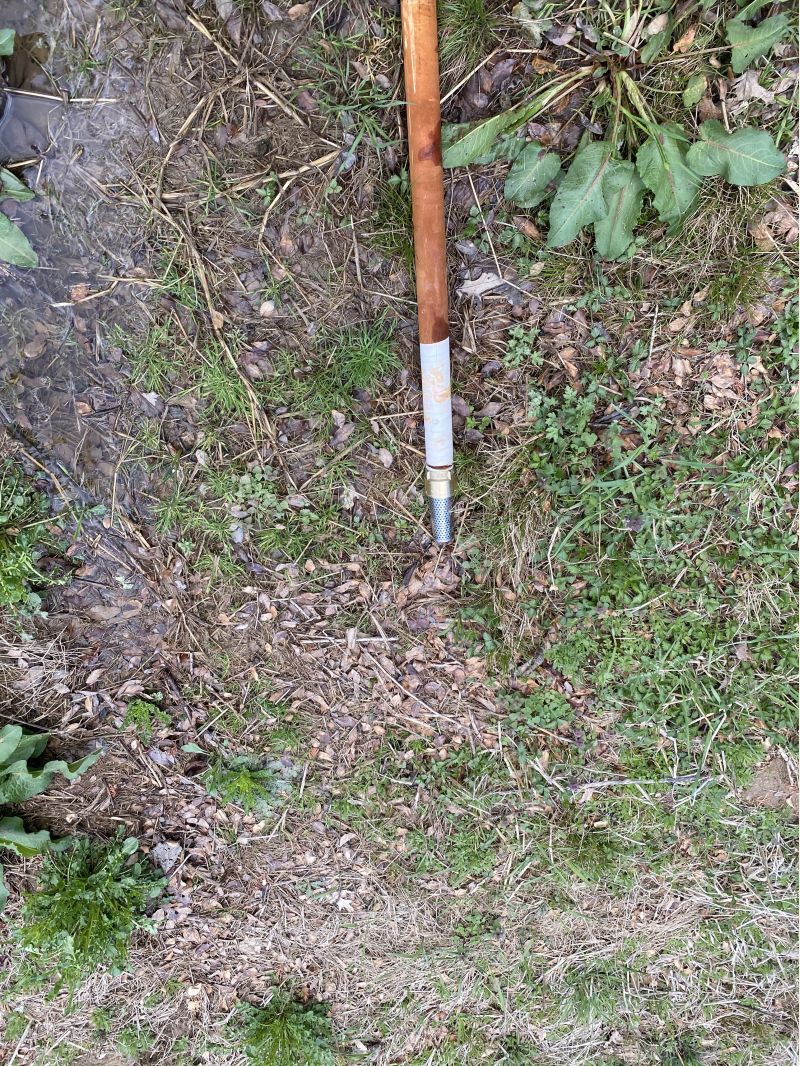

# Posted: 19 Apr 2021 08:25am
Well (no pun intended) the weekend is over and i'm back as a pessimist! Well pounding was a no go. I witched/dowsed 2 different spots on my property and got everything set to drive the pipe.
I rented one of these from the local hardware store and it didn't do squat. Didn't even drive the pipe down an inch in the sandy soil. If i hit the pipe with the sledge, i could get about 2" per swing. But, with the condition of my neck there was no way that was gonna happen for another 250+ inches so i called it quits. That was a wasted $75.
The specs say 45lb of pounding weight but it felt nowhere near the same the jack hammer deal i rented the last time i did this. I think most jack hammers are around 65lb, but still, this thing was useless.
